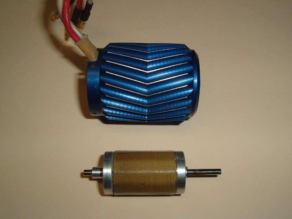

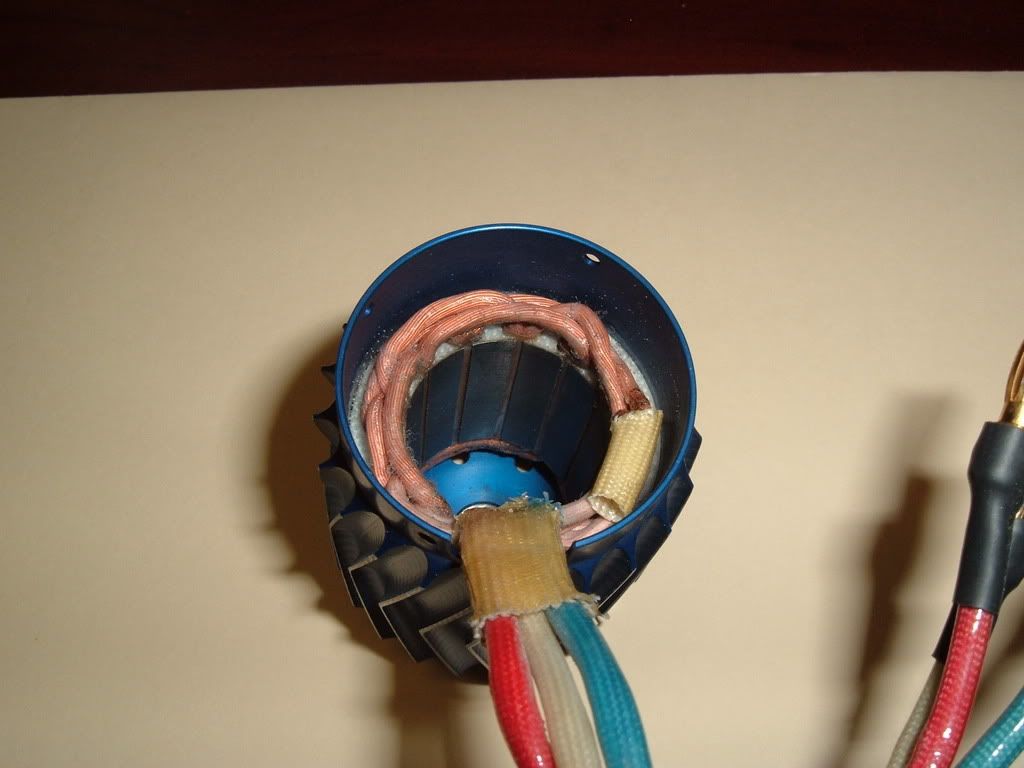

Here ya go, a plett maxximum with his pants down
It is a 6 pole motor. It has an 1/8 shaft all the way thru, and the bearings are different from my plett maxx w/fan so not too sure about getting a 5mm shaft rotor in there. The front of the can is intergral, so not much chance of getting a bigger bearing in there, without machining.
The polished fin edges were done by me, I like the way it looks better than solid blue...
Very nicely made motor, not sure if I want to sell it now...

Well that's pretty cool. I always take stuff apart to see it's innards. LOL
What kv is this?
07.24.2008, 06:40 PM
Definitely a slotted stator design. The coils look very neat and tidy. And the magnet looks pretty large in diameter compared to a typical 540 Feigao.
07.24.2008, 06:41 PM
Somewhere around 3000kv. I have ran it in a crt.5 and a flm pede on 3s, and an emaxx on 4s. Definately has plenty of torque.
I did not play around with the timing much, but plan to try my other maxx w/fan with a variety of settings. That motor is in the new emaxx with a griffinru stage1 mm. I run it with a pair of trakpowers in series for 4s. Current gearing is 18/68, way too low. I will say that the fan can move some air. feels like a hairdryer! I need to gear it up, and increase the timing, as the multipole motors seem to run better with higher timing...

is there any way to wrap the rotor of a feigao motor with kevlar or CF?
07.24.2008, 07:31 PM
Not sure if there is enough room between the rotor and the windings. If there is, you just wind the kevlar string on with a power drill, and then brush some epoxy (or the correct stuff) on the kevlat string. At least that is what I have been told!
Yes.
lutach
lutach's Avatar
Posts: 5,139
07.25.2008, 12:09 AM
If there is, you just wind the kevlar string on with a power drill, and then brush some epoxy (or the correct stuff) on the kevlar string.
Correct.

07.25.2008, 01:31 AM
Your Pletty looks good lincpimp.
Thanks Luciano...
Looking at the rotor, it has 12 flats on it that can be felt thru the kevlar wrap. Does that mean it is a 6 pole motor? Or am I missing something: reasonong is that a magnet has 2 poles, and 12 divided by 2 would be 6?
If it is a 6 pole motor, should I run higher timing? Would that improve performance?

Thanks Luciano...
That rotor looks just like the one in my Extreme. They might use 2 magnets per pole. Funny thing you asked about timing. The 6S controller that I've been testing was acting up when I had low timing running the Aveox. When I went to mid timing the controller worked perfect. Now days I'm getting more and more confusing as some companies say to run low timing to keep temps down. I always go mid or 5 degrees of timing for 4 pole motors and high or 10+ degrees for 6 pole motors. My 60A controller burned when I changed timing on it when I was running the Mega ACn16/15/1. I had 15 degrees of timing and it was doing awesome, but I made a mistake and changed the timing instead of another setting and a couple of FETs went dead.
