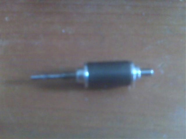

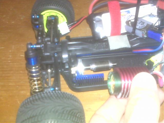

All joking aside, I realized it wasn't a total disaster, the can came off of the end cap, and the center shaft was left there as well. I looked at the end cap and saw some epoxy residue on there, so whipped up some JB Weld, was careful not to put on a ton (can't imagine that'll help things spin freely when it dries), and got it back together with some vise work (couldn't do it by hand).
It's drying now, but I did lightly drive around my apartment and it's spinning just fine.
Enjoy the pictures, and if my tactic doesn't work the same for you, post your method so we can compare notes.
