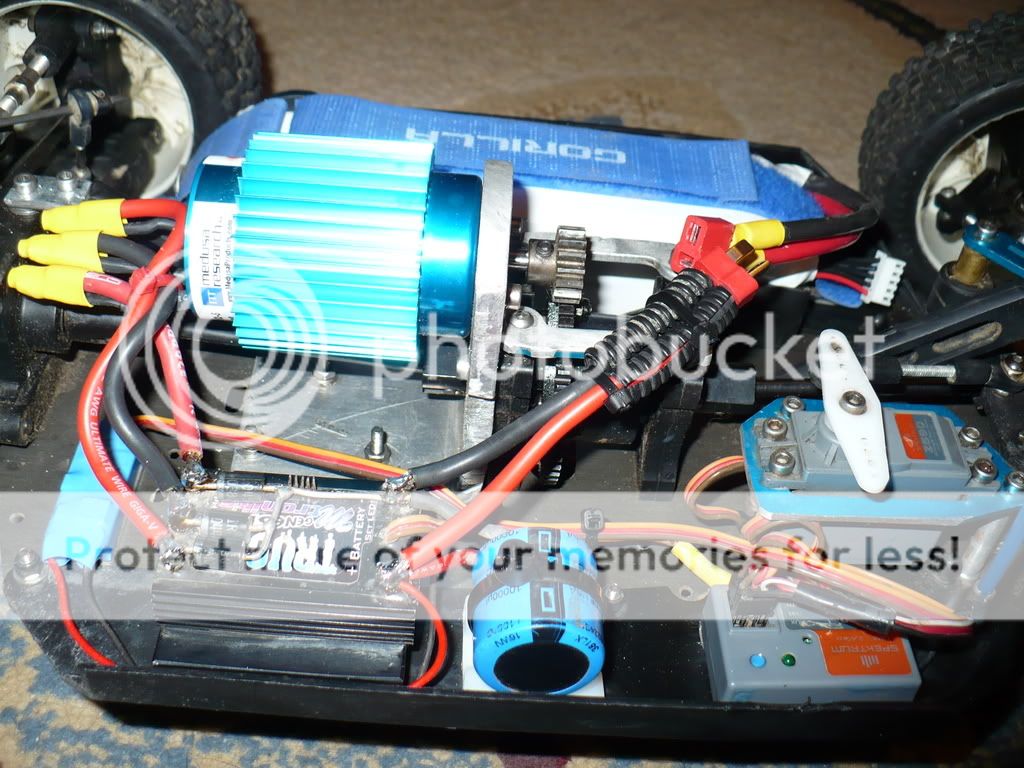

Alright, I've pretty much had enough with the glitching problems I have had when I have tried to use an External BEC. I have tried two so far and both have been terrible.
The first was a cheap $6 unit from Hobbycity, which I can understand I guess. But the second was a CC BEC, in my opinion CC could have done better with this unit.
So now I just ordered a Dimension Engineering SportBEC, please, no body out there tell me that they have had glitching problems with this UBEC!!
This is my setup...

When I ran the Truck ESC I always used the internal BEC, even on 4s. The same exact problem occurred for me that you are having - an external BEC causes glitching with that ESC. Same goes for having an external LVC.
09.13.2008, 03:45 PM
The cheap BECs and the CCBEC did have some noise on the power line during my tests. The DE BEC I tested had none (it was the small one though), so I imagine it's bigger brother would be similar in performance.
A couple things to try is to add a small 1000uF (or higher) 16v capacitor on your unused receiver slot. Also wrapping a turn of the throttle cable through a ferrite donut ring may help too. Your low-level wiring looks well isolated from the high current ones, so that should be fine.

whats the large round component between the Rx and ESC? I have a feeling the BEC isnt causing the gliching
tc3_racer_001
tc3_racer_001's Avatar
Posts: 701
Location: Brisbane, Australia
09.14.2008, 04:44 PM
that would be a huge capacitor. perhaps moving it may help but the wires have to be short so where else could it go?

I would remove the cap entirely, I think it way overkill for no reason, caps store energy and its better to have multiple smaller caps as opposed to a massive one and relocating the Rx to a point further forward and higher would help

The capactior that is there is the one that came with the ESC from the factory, I didn't plan on changing it. I tried moving all of the wiring around and it didn't help at all.
Also, it has to be the UBEC causing the glitching because if I run the car without it... it doesn't glitch.
