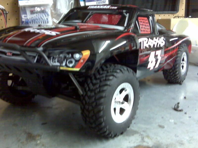

OK, enough of that non-sense...
Out with the old power...
IN WITH THE NEW POWER!!!!
I would like to introduce you to.......
E-SLAYER!!!!!!!!

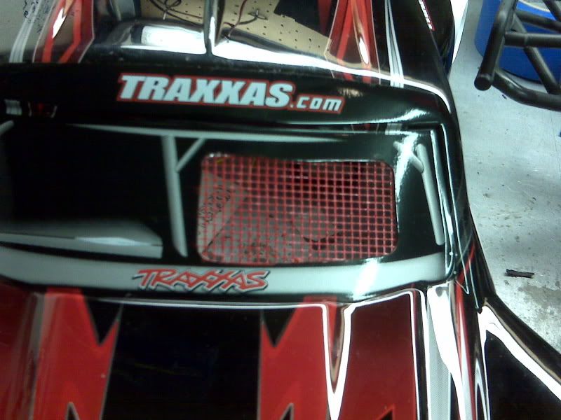

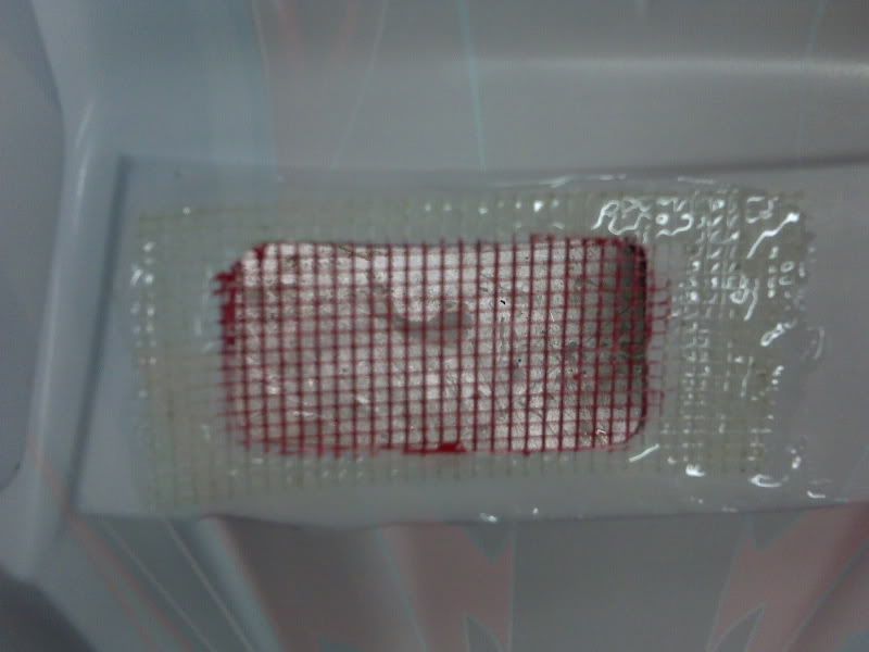

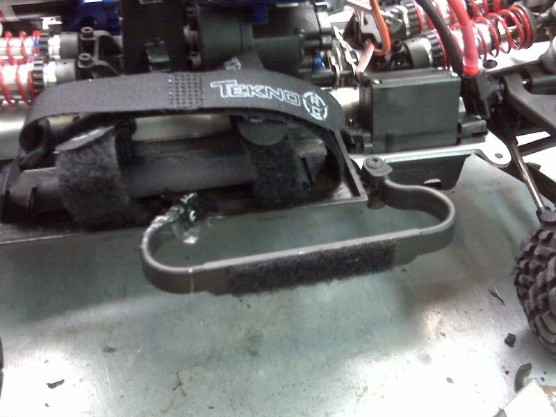

OK..the kit does not allow for mounting the side bumper and I really want to keep it on. I notched the battery tray and Shoo Goo'd the side bumper to the battery tray. I hope that it holds.
Next thing was to cover that huge hole in the windshield to avoid material flying through. So I did what I used to with my Nitros. I used some mesh that is uses for repairing lexan and Shoo Goo'd it in place. To make it look better, I painted it red...
Now I just need to get out and test it...
