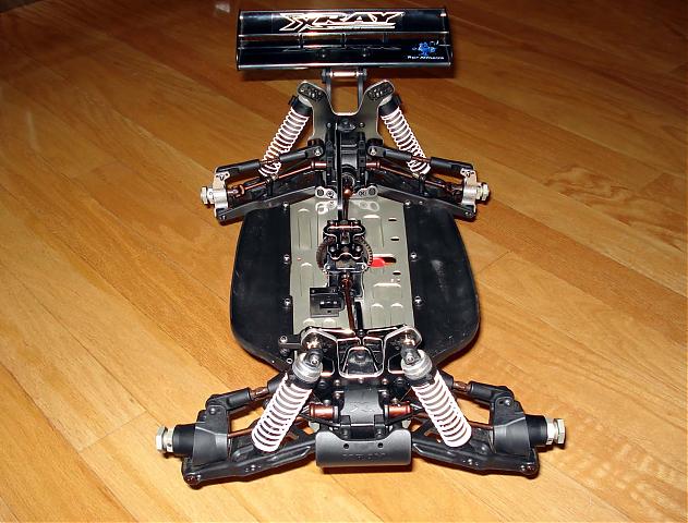

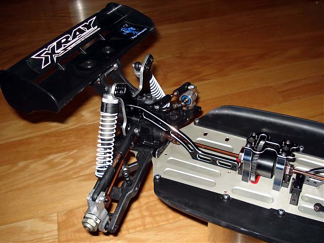

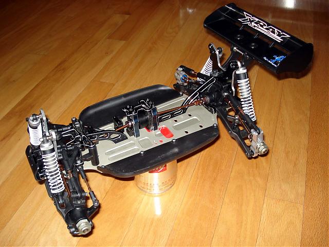

So I had told myself that I was going to take a break from starting any new projects or buying anything until the new year.... I guess that didn't last too long... I made it nearly four months without buying anything r/c related, but broke down and went on a binge recently. It just goes to show you that diets don't work... moderation is key.
I recently bought a new motor for my crt.5, new lipos to match, more lipos for my XT8, and finally this beauty of a buggy. This gorgeous thing was just sitting on ebay for $200 shipped, and had ZERO bids! So I had to snap it up... it would have been a tragedy to see it go unsold for that price. It would be like being able to draft Adrian Peterson in the 6th round and passing him up! You just don't do that.
But, I digress...
The chassis is the EC version, near mint condition, and has almost every cnc upgrade that xray offers. Plus a whole host of spare parts and fresh tires. I'll be transplanting all the electronics from my Jammin X1 to this buggy. They include a Neu 1512 2.5D, MMM V2, and 4s Neuenergy 5000mah lipos. I'm just waiting on the Xray motor mounts to come back in stock, and I'm all set to go. Hopefully it will be up and running in time for the next So Cal Bash.

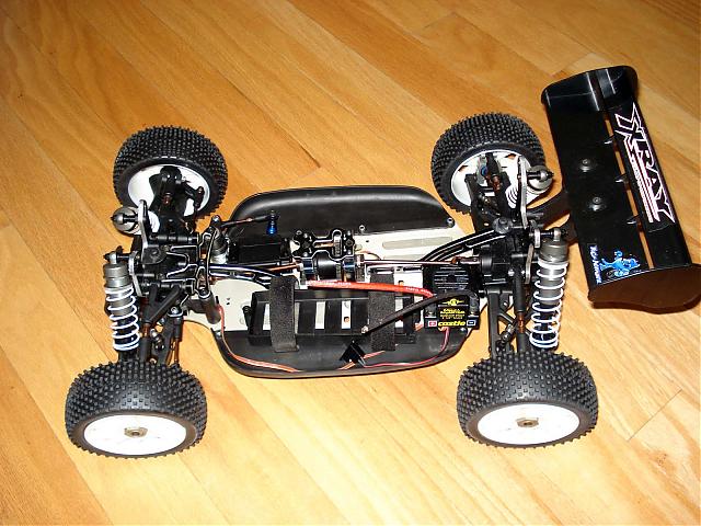

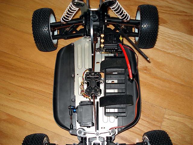

Progress this week... didn't have too much time to work on it, but did enough to warrant a pic update. I was able to add the esc mount, battery tray, tires, and 16mm jammin shocks.

That battery tray wasn't removed from an older E-Maxx chassis, was it? I've got two of them that look just like that. Looking good so far!
macr0w
macr0w's Avatar
Posts: 225
Location: Charlotte NC
11.09.2008, 09:57 AM
What kind of batteries do you have that will fit that tray?
It looks kind of short.
Most of the good battery packs are at least 160mm long.
rootar
rootar's Avatar
Posts: 1,803
Location: arkansas
11.09.2008, 11:18 AM
looks good ! im also curious as to what batteries your using.
rschoi_75
Certified Spaceball
rschoi_75's Avatar
Posts: 675
Join Date: Jun 2007
Location: CA
11.09.2008, 02:34 PM
The tray is indeed from an old emaxx chassis. The lipo's I'm using are Neu Energy 2s 5000mah hardcase lipos (x2). They are 137mm long, and fit in the trays perfectly if you stand them on their side. I like the whole modular aspect of these batteries since I can use them is 80% of the r/c's I own. I just had to dremel a little slot on one end give the balance tabs some free space. Here's a pic from my truggy showing the batteries (below). It uses the same tray. * On a side note... I actually noticed Mike just reduced the price on his battery trays. I'm strongly considering getting one, but I don't really have a need for the additional length.

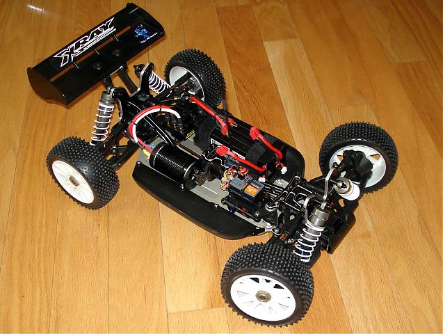

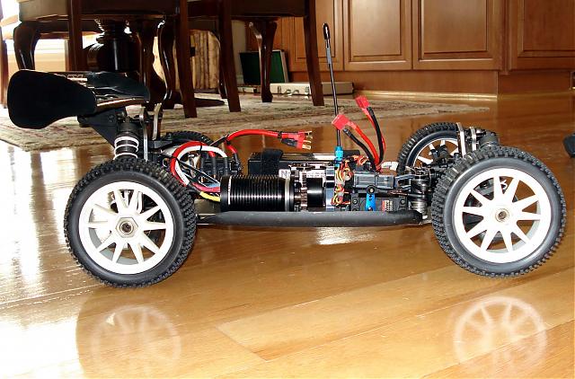

Conversion Completed!
I just received my motor mount from Daf the other day and here she is! I am in the process in working out the kinks and trying to get a short video made. This buggy is so smooooth to drive! Everything is nice and tight, and my first impression is a good one. Hope you enjoy.
