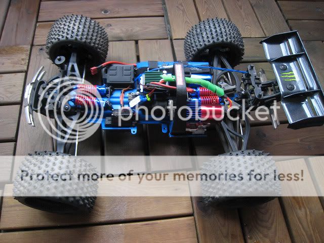

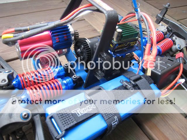

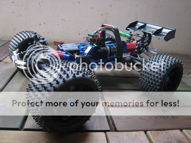

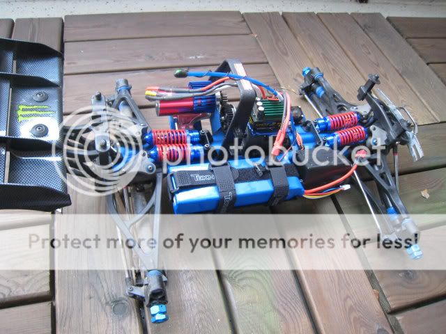

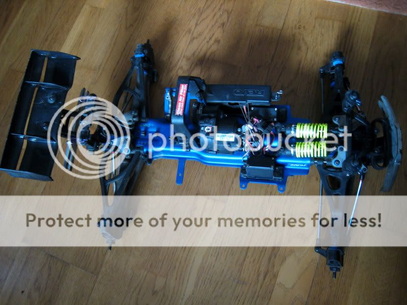

Hi all! Im Mikko from Finland and new in here.
Im almost completely finished my E-Revo conversion.

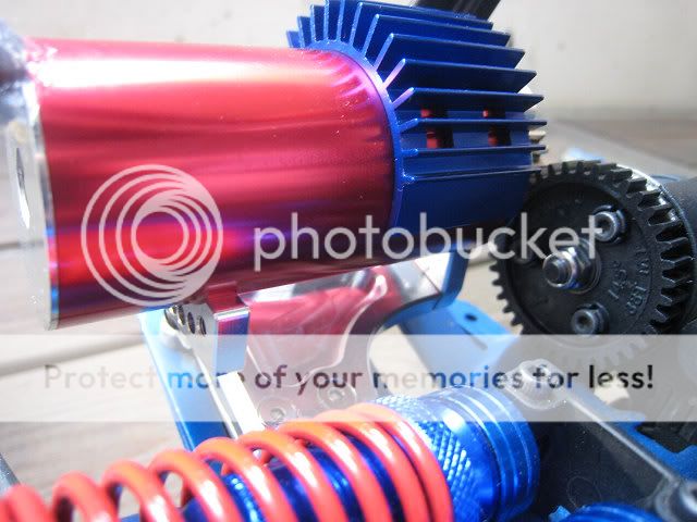

The tranny is modified to lock into 2nd gear to enabling motor brakes and reverse.
Im using a RCM Revo motor mount, a Tekno-RC esc and batt mount, receiver box.
Mamba Max esc with ubec, 1900kv xl chinese motor, 4s zippy 5000mah lipo battery.
Here are some pics of my build so far. 8)
some new stuff:
Revo with removed nitro gears:
2d gear mod:
tranny completed:

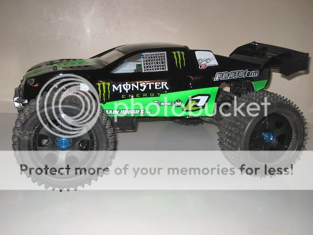

Some more.
New body and wheels/tires
11.14.2008, 07:00 PM
Sweet! Love the green bead locks w/that body.

Have you done any mods. to the mm esc? With 4s, you should add a cap to help w/cooling...like this one...http://www.rc-monster.com/proddetail.php?prod=35vcap
Use the one w/the leads...it's easier. Also, that motor may not last very long...not the best quality. When it blows up, look at the Medusa line or Neu line of motors. The cheaper motors just don't last very long....just a suggestion.

Thanks!
Not any mods in Mamba esc yet. yeah that motor is cheap, but it run pretty well today when i tested it.
I thing im getting a Medusa 70mm 2300kv motor later, i ve heard only good about Medusas.

Did you do your own painting? If you did....well done!
11.16.2008, 05:23 PM
Stod = ?
-rcmh-
11.16.2008, 05:32 PM
Yup, i painted it. i like how it came out.

Are you using this motor? - http://www.hobbycity.com/hobbycity/s...hless_Inrunner
I was thinking about getting a different size of that motor for my crt .5.
-rcmh-
11.16.2008, 06:32 PM
Yes, exactly that motor.

The truck looks awesome! And like the others, I do recommend a better motor. Also, the body looks great, and I was wondering what was the exact type of paint you used for the green. Do those mashers balloon alot?
