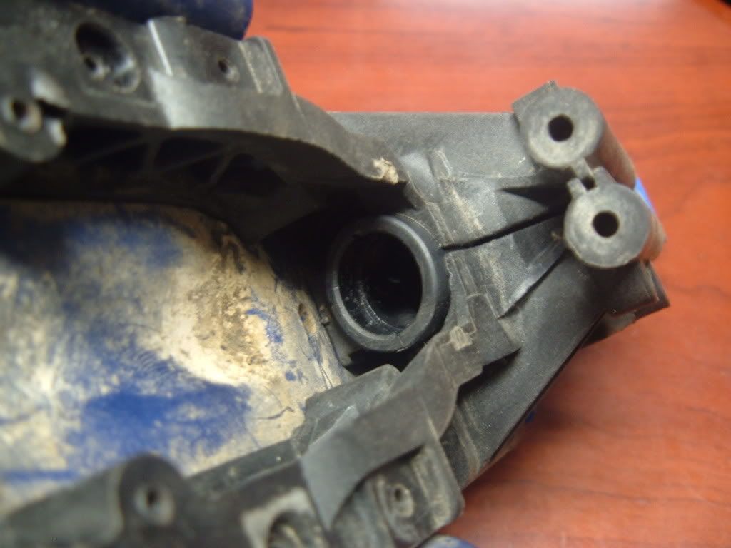

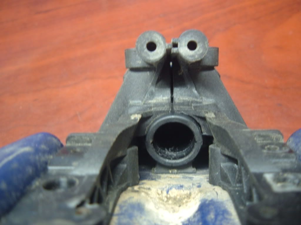

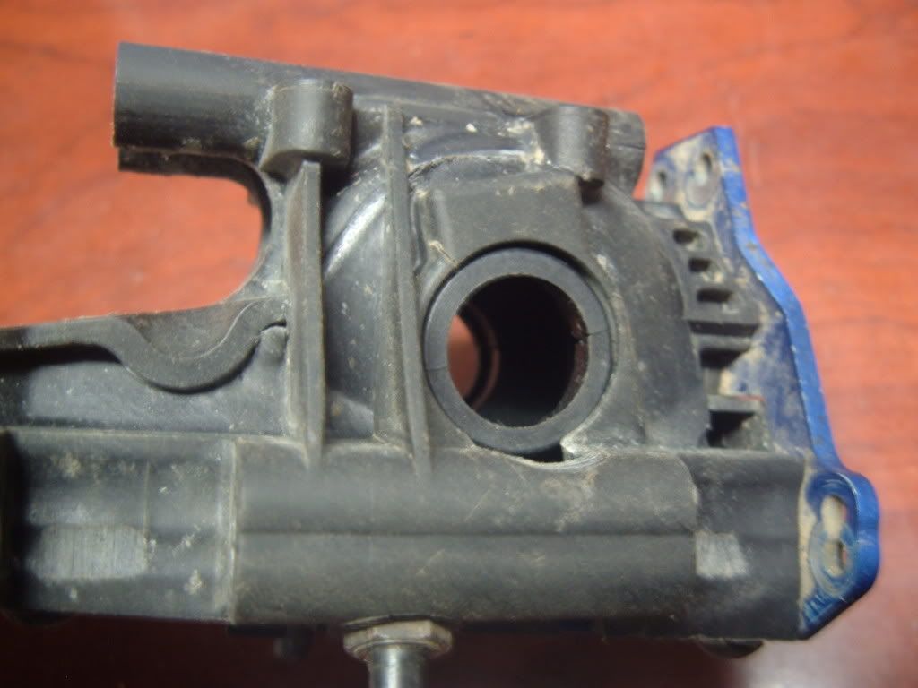

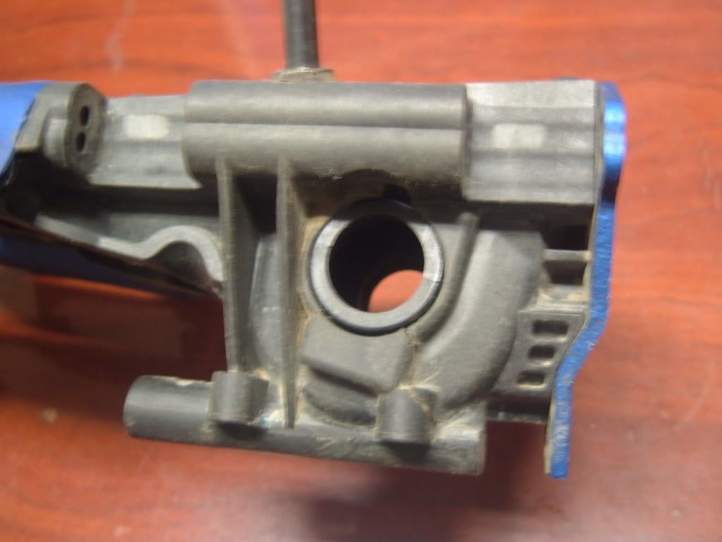

Ok, so a few people asked me to look into this. A very nice man (JThiessen) sent me a piar of revo bulkheads to experiment on. Here is the result:
Needs a slight amount more work to get the bulks to touch without a little bit of flexxing. This is definately the cheapest way to get good diffs in a revo. Expect my 1521 powered revo to have lst diffs...

Thanks, I will get a diff built for the case and see how well the center driveshafts line up. The stock lst diff outputs should fit most cvds. The input will require a 8mm id cvd cup, or mike's adapter to use the stock sliders. I have those adapters so I will give them a try. I will test with a stock revo chassis and an erevo chassis.

Looking good Linc. Looks like you should be able to just clamp the two bulks together and run a drill into the input shaft hole to open it up. Could you mic that input casing on the LST?

I think so. My only question is clearance for the center driveshafts. I know cvds will fit fine, but I am not 100% on sliders yet.
Thanks. Not sure if I have a large enough drill to do that, plus addl material needs to be removed in key areas to allow the cases to fit. Bit of trial and error involved. I will assemble the diff and put the lower skid on the bulks. I want a tight fit, but do not want to distort either the bulkheads or the diff case.

could you post some pics of the inside of the bulkheads
Let me get them finished and I will take a few snaps. Depending on what I can get figured out, I may make up a few sets, if anyone is interested...
It is not a difficult mod to do with the right tools, but there is not a ton of material to work with, and specific areas are very hard to get right.
