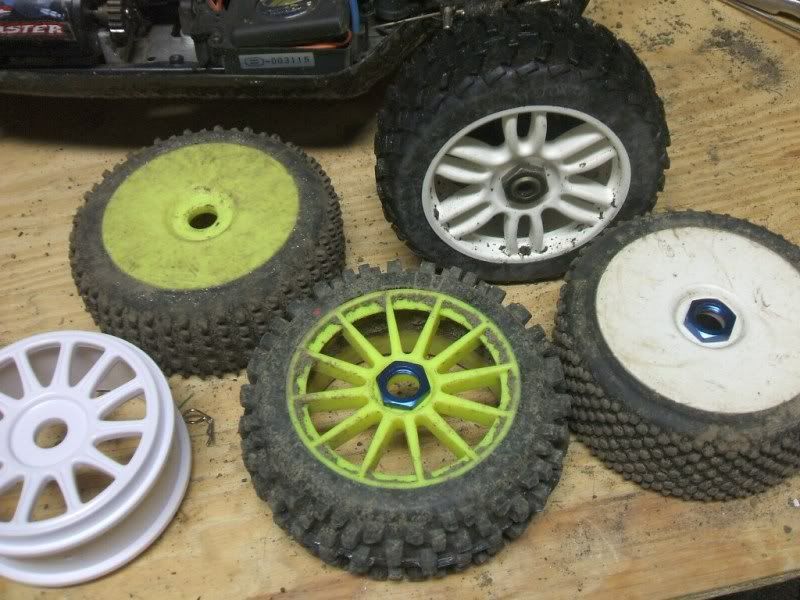

I've got a thing for tires and have started my collection of buggy tires and found a couple things out. Some or all of you may have already known this but I didn't until after I had them glued on the wheels. Anyway here's my contribution to the thread. Hope the rest of you jump in and share what you think would helpful to other new and old buggy owners.

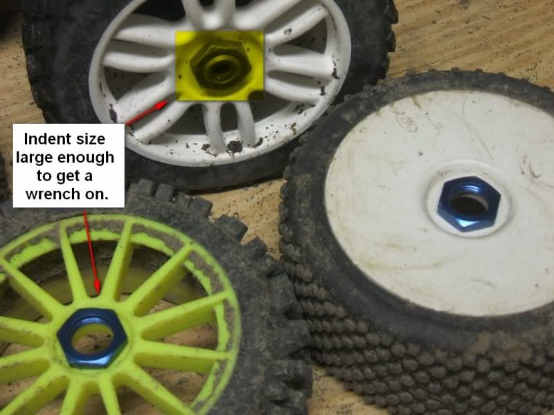

One thing to look out for when buying rims for you buggy is to check the indent around the nut. I already had the badlands glued to the rims when I found this out. Once I took the wrench out to tighten the nut down on the tire. I found that the indent around the nut wasn't large enough. The indent wouldn't allow my wrench to slide down on the nut to tighten it. I did my best to tighten it but I ended up losing a 17mm nut due to this. I will be able to use the setup on my slayer with the 5mm locknut. It would be a pain to run these on the buggy all the time. You can see in the picture below the amount of space around the nut on the white rims that your wrench will fit down into. The yellow rim with the badlands indent comes right up next to the 17mm nut.
I like the looks of the spoked rims better but I am finding they do have thier downside. The rims that have spokes in them are more prone to getting locked up by rocks, twigs, etc while I am out bashing. May not be a problem while you are on a track that is cleaned of that material.
