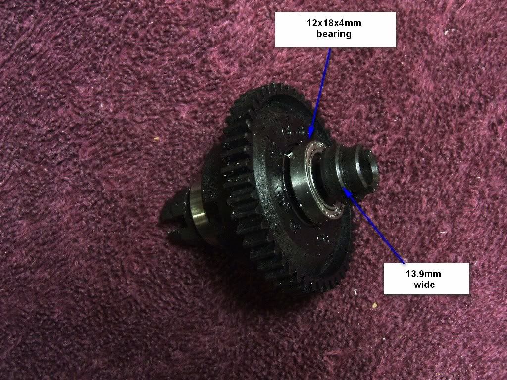

The question/problem here is getting the DST center differential to work with the RCM Kyosho motor mount.

Problem with the Kyosho D series of 1/10th 4wd that Kyosho is putting out is the center differential output shafts require a 12mm bearing so they are using a 12x18x4mm bearing for the center differential. All of Mikes current RCM motor mounts fit bearings that are -- x 16 x 4mm. 16mm or less except for one the OFNA Ultra IIRC. It takes a 19mm bearing.

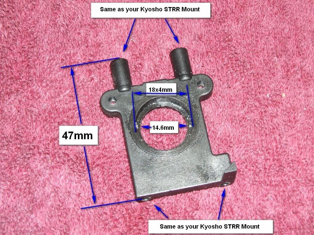

As you look down the list of options I came up with. The odds of it actually working get better the higher the number. All the options using the RCM Kyosho mount will require the steering servo to be mounted on the other side of the chassis.
1. Use the Ultra Motor Mount then you would need a 19mm bearing. The inside diameter needs to be 12mm for the differential. I only found 12x19x4mm bearing in kits there were made by Acer for $100.00 and those have been discontinued. Not even sure if the mounting holes would match up with the Kyosho chassis.
2. To find a bearing that would work with the RCM mount and the Kyosho center differential would need to be 12x16x4mm. This would be the easiest if they could be found. I had no luck finding any bearings of that size.
3. Take the RCM Kyosho mount and increase the size for the bearing from 16mm to 18mm. I have the RCM mount here for my truggy and have looked it over. There is enough material around the current hole to increase it to the 18mm but it will require some patience and a steady dremel. At it's narrowest spot where the bearing will ride it is 20mm. That leave 1mm on each side. I have a hard enough time drawing a circle if I am tracing it around a glass. It will be a challage to get a real nice one for me. Easy to see what I mean in the picture.

Kyosho Center DIfferential
RCM Kyosho Mount
