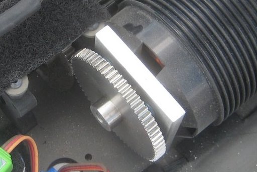

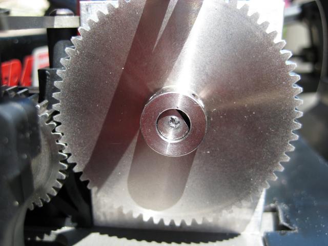

I used 1/4" aluminum for my motor mount for my Neu 2215 and it works great:
ID:	6263   Click image for larger version
