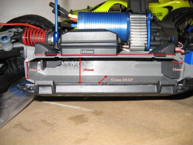

Here's a pic of the battery compartment courtesy of Hoov. It might not fit.

It should fit ok. There's actually about 180mm in length, it just tapers down outside the 160mm length. The 165mm length should fit ok since it's only 25mm tall.

You can fit bigger, you just have to use a shoe horn and some grease like I did! All joking aside though my FP packs are larger and the fit with a little persuasion on the locking tabs. I have jumped off 6'+ heights and banged around and the doors have yet to pop open. I think other than being a little small, Traxxas designed the compartments very well.

The pic is good info.
Guys, thanks for all the info & comments. While I like the flightmax ones, I worry about the 50mm width. Then, there is the littel issue of wire lead management.
