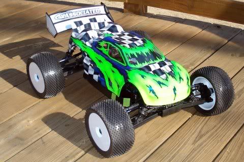

my new toy:
came with new DX3r system
and Hyperion 0610 charger
Video as weather clears up!!!

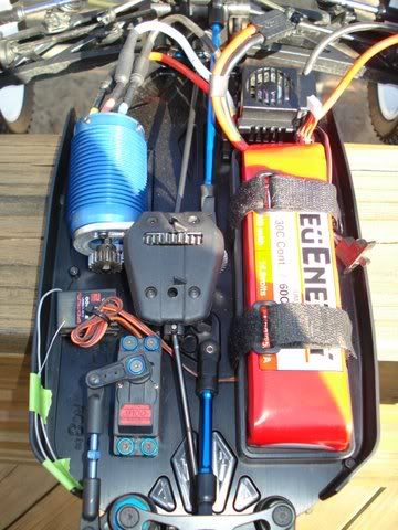

I have to mention a concern I have with your setup though.
Your ESC bullet connectors look too close to the aluminum chassis brace for safety. If the esc comes lose and moves it could short out the bullets to the brace and poof
I'd suggest rotating your esc 90 degrees to help eliminiate that possibility.

Sweet, Mike's chassis set up is sooooo nice!

Very nice man!

Originally Posted by starscream View Post
Lookin Good
It's fine. There are no bullets its a V.1. But good looking out.
Looks great plettenbergs!

Looks real good Matt!!!!

Uber cool.
A V1?
Well, good luck with it.
Hopefully it lasts longer than mine did.

i hear great things about the Castle service!
i also have backup ESC's if i have to send it "back to its maker"!

I ran the truck today,actually my 9 year old drove it mostly...it ran for about 25 minutes in my yard...temps were very low with 17/54 gearing and a NEU 4s 5000...was not that impressed with the top speed!
I just installed new 46 tooth spur gear and charged two new ZIPPY-r 4800 18.5v batts for tomorrow!
Also running BADLANDS on truggy wheels
ANY SUGGESTIONS?

what about running it on 5s?
