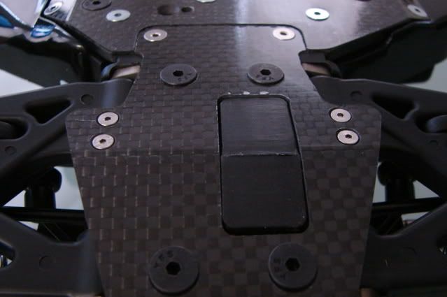

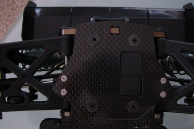

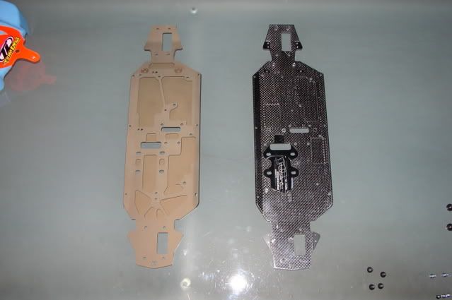

afew weeks ago i picked up a matrix carbon fiber chassis, carbon fiber steering drag link set and carbon fiber front and rear shock towers for my lite weight losi 8ight project. Over all the fitment is good, the rear outer hinge brace hole needed alittle sanding to fit and the counter sinking on the replaceable front skid plate could have been deeper
the carbon chassis is 1.5mm longer than the stock chassis
here is a pic of the front countersinking that needs to be better
the rear countersinking

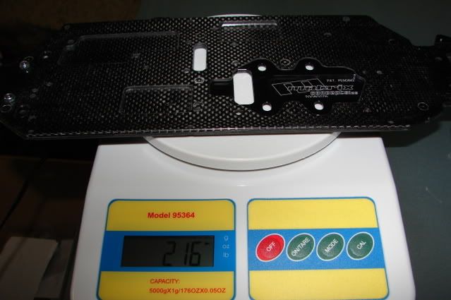

so is it worth the money? we will see this race season, does it save weight?

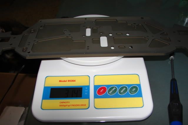

here is the stock chassis weight
and the matrix chassis
so over all it decreases the chassis weight by 99 grams
the steering ackermen Weighs in at just 20 grams, compared to the 38 gram stock one and the fit and finish is perfect.
the matrix carbon front shock tower weighs in at 12grams stock is 24grams
the matrix carbon rear shock tower weighs in at 20grams stock is 38 grams
so over all the matrix concepts parts shaved 147 grams off of my brushless 8ight

when are you going to be racing it? im really intrested in how it performance.
Also Wondering how much the over all car is going weight when you put the esc, motor, batterys and servo.

Just about a 1/2 lb. weight savings...not bad and it definitely has a coolness factor of 10

all of the screws but the front skid plate sit flush, i have 4 front skid plates for it, it may be just this one, anyway its an easy fix to just counter sink them right and then CA the holes

well im going to have to say matrix has very bad customer service, i have been leaving them messages and e-mails for 3 weeks trying to get ahold of them about the front countersinking.

well good new, i called and left another message, afew hours latter the owner of matrix call me back ( i wonder if he reads here?)
we did some investigating and figured out the two front holes were about 1mm off and that wasn't letting the screws sit down all the way on the chassis.
he was very cool on the phone and truely sounded sorry for not getting back to me sooner.We talked about the production and he said i was the first person who has had this problem and that he was sending a new chassis UPS 3day and he was going to test fit it just to make sure i didnt get another odd ball

good news, i got the new chassis and everything fits great on this one
