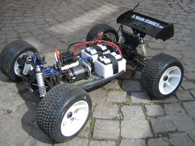

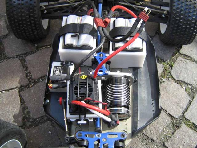

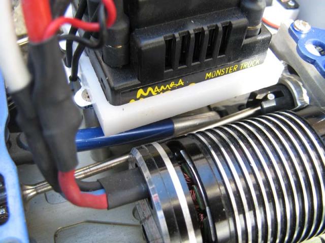

My ST-RR - 03.28.2009, 07:11 AM
I accept your advice
The new body is not yet ready... All details must be in ptfe lightened and colored
configuration is:
8s A123 (4+4 in series)
MMM
Align 600xl 1700Kv
Pinion 14
spur 46

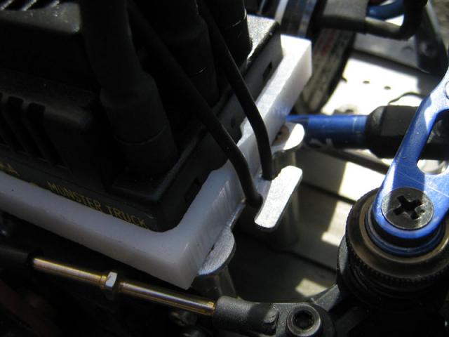

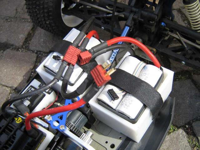

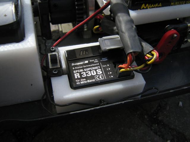

03.28.2009, 07:13 AM
Other....

03.28.2009, 10:07 AM
Very nice and clean installation. How's the weight distribution with all the batteries in the rear?

03.28.2009, 10:16 AM
I believe very neutral even jump in the car behaves better than single lipo pack lateral

03.28.2009, 03:29 PM
How does the mmm hold up the 8s life? It's slightely over it's specs. Very interesting setup you have indeed. Nicely done!
