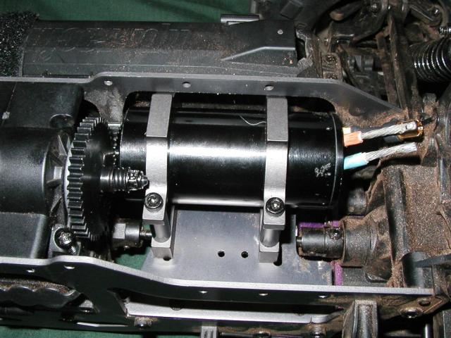

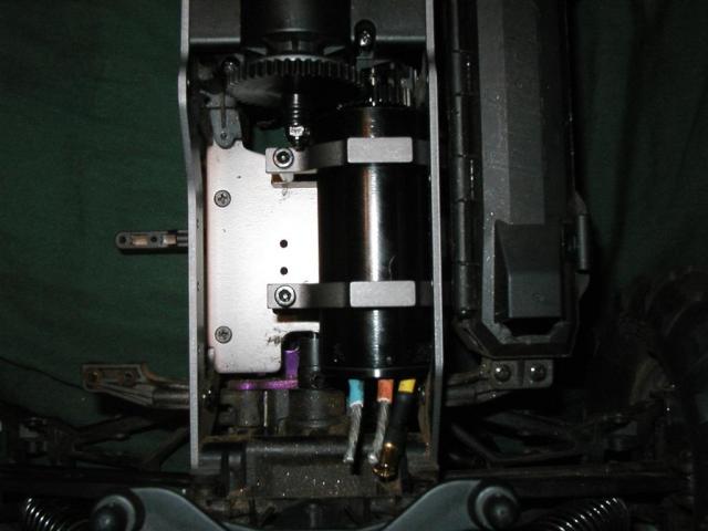

Just starting a new 8S Flux project. The Neu 1521 motor drops right in with no major problems. I broke down and bought an MGM 25035 ESC for the build. I haven't had the best of luck with MGM's, but it's the only 8S high amp car ESC out now. (I know about the HV 110. Not enough starting power for wheelies and backflips.)
Check out the new Integy tie rod eliminator rear hub. Integy claimed in an e-mail to me that these are 6061-T6. Usually Integy stuff is crap and they lie. So I took it in to the metallurgy dept. where I work and they confirmed it! It is 6061-T6, we'll see if it holds up.

Looks good, nice to see that the 1521 fits in there with the stock flux mount.
I am planning to run a 1521 2y on 10s lipo in my savvy. A buddy is working on a baja 5t length chassis for me, so I doubt it will be anywhere near as crazy as your setup will be. That is alot of power in a truck that size, do you plan to gear for speed?
What wind is that 1521? And any chance of a link to those integy HD rear hubs?

Linc, I love to bash with larger type tires like Big Joes. So gearing will be on the lower side, I'll have to experiment. The wind is 1Y (1577 kv). Like to keep the RPM's high for stunts. Most likely I'll end up going back to a 1515 but it's fun to try different things.
