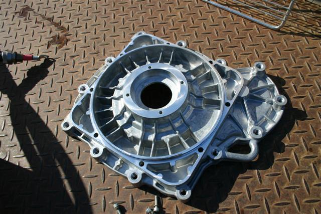

Hey guys, just thought I would post some pics of the inside of one of the motors I have for electric car conversion. It's an AC induction machine, so obviously it's brushless... but the reason I opened it up is because I have to put different (sealed) bearing in it, rather than the open type that are in it (because they were oiled from a planetary gearbox built onto the motor).
Cheers!

Holy crap! I'd hate to be the one to lift that rotor out... must weigh a ton.

I like shiny!
That is one huge bearing

How come all of the metal tools and the spray can and stuff arent sticking to the side of the giant magnet. I have to imagine that thing must have some serious pull.

The magnetic pull can't be that great or how the hell would he have gotten the rotor out of the can in the first place? Still I would think the spray can would be attatched to it. IDK?
04.07.2009, 06:15 PM
Is the core a permanent magnet, or is this an induction motor? I would think it's an induction type, which would explain the lack of attracting any ferrous metal within a city block!
Cool motor ZPB! Do you have any specs on it? Like kv, max rpm, max current/power, etc?

Those Siemens motors are built very nice. Siemens is one of my client and I asked them if they could make a compact, but very powerfull drive system and I'm still waiting for an answer. Good thing I have a few military clients who are in the industry . Just got to come up with the huge amount of $$$$ to get what I need done .
Not sure what model he has, but here is a spec of the 1PV5135WS14 model:
Make/Model: Siemens, 1PV5135WS14 induction
Type: 3 phase EV AC PM synchronous motor
Rated / max voltage: 215V / 380V
Rated / max Power: 45 kW 61.1hp / 78.4kW 106.6hp
Rated / max RPM: 3,500 / 9,700
Rated / max torque: 120 Nm 89 ft-lb / 190 Nm 140 ft-lb
Max current: 400 A peak 282 A rms
Dimensions mm: 425x245 x245
Weight (motor only): 91 kg 200 lb
The inverter was the Siemens Simovert short (6SV-1) and here are the specs:
