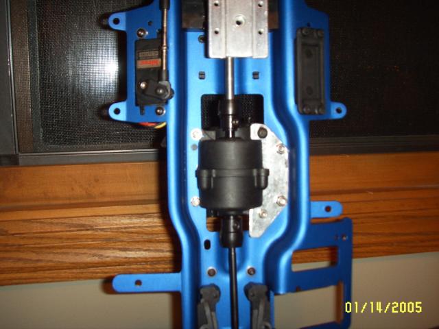

Hi I am in the process of a 3.3 conversion. I have the 3905 center transmission, UE 6mm drive cups, and UE drive shaft. The drive shaft seems to have a little bit of play (4mm or so) but it is still very much inside both cups...my question is, should there be no play at all, or very minimal play(like 1mm)?

I am running into a prob. w/my 3.3 conversion as well...my new v3 diffs have a different cup diameter than the inner diameter of the ones on the trans. I have a set of dogbones that will fit, but one end has some play and the other does not. I am trying to find a cup that will fit on the trans that has the same size inner cup diameter as the dogbone.....needless to say that is my challenge.
In answer to your question...on my buggy, there is about 2mm of play..on my crt.5 there is about 3mm of play w/no issues

right on mag I just needed to see if it was ok for some play..that rhymes
you're using the 3905 transmission also, right? I have the v3's as well and I'm using the UE 6mm transmission cups, but the ID's aren't slotted;the just use two set screws to hold the shafts so I made sure that it it really tight w/threadlocker...good luck with your situation though.

Use some fuel tubing in the cups to center the bones...

Fuel tubing? In the drive cups you say? Why, the mere notion of it is...well I will have to try that!

I use S3 o-rings on mine.
