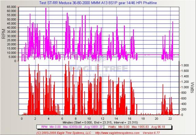

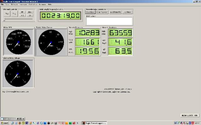

My car is already know ... There are a few photos around ..... is a truggy kyosho ST-RR that given the many satisfactions years ago, I wanted to give new life with electic motor .....
was pushed up by a 1700KV align..... from the one I wanted to give Medusa .... in particular 36-60-2000.
Well the result is astonishing with the align was good ...... Medusa takes off with .... we were on the apron where around bashing test and some .....

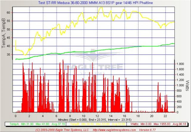

I did a couple of laps without body to see how the temperatures were ...... after saw that everything was under control I have enjoyed some stress rather launch at full throttle and braking hard facing due to rollover curves taken at insane speeds with the tires hot hot ......
with me was a friend of the italain forum below even here .... if he had the gun laser .... which gave readings between 75 and 80km / h speed in my opinion compared to all ..... not to mention the progression with which to get there .....
the Medusa runs fine without any hesitation and the MMM is totally free from cogging, temperatures always at levels acceptable in my opinion and the fan of MMM has never match ..
with battteriy (A123 then 2300mAh) I run for more than half an hour and I had stopped only because I made too late to bring children to the movies ........
The screenshot of what the datalogger recorded palano alone if you want more info ask at your disposal
