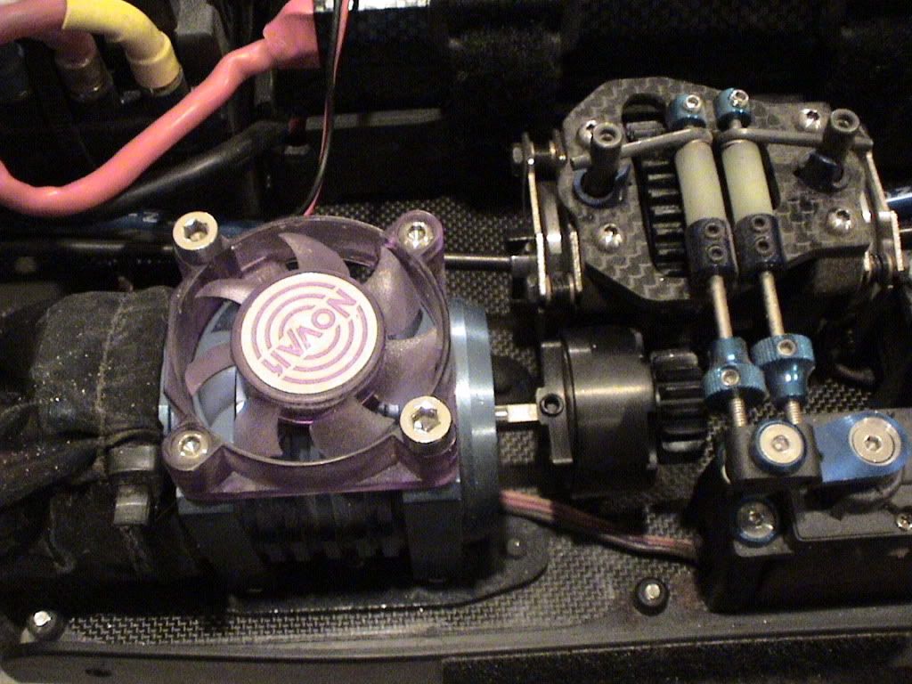

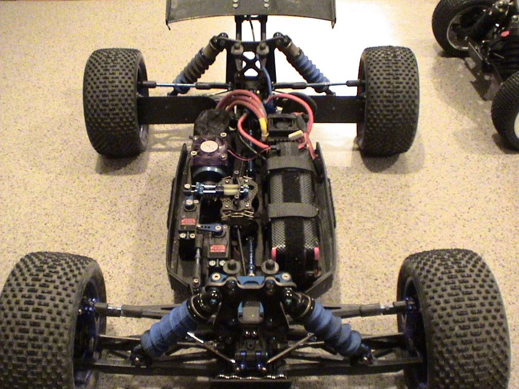

i posted this build last fall but wanted to show some recent changes. the biggest thing being these Fioroni spring flex chassis braces. these things increase handling and manueverability on the track dramatically, especially over rough track. you can get these from Amainhobbies for several different 1/8 kits but the ones i am using were actually for the HB D8T and like a Kyosho buggy or something. i just made them work with my setup. i think the rear is most important and the front isnt as crucial. i am going to try running the composite RC8 chassis brace up front with the Fioroni spring brace in the rear this week and see how that goes. i think it will be the perfect combo.
i did the steering rack mod that the AE pro drivers have done and this has helped a ton too. steering has much more throw and much better feel when driving. i highly recommend this for anyone driving the RC8 and RC8T. just google "rc8 steering rack mod" and you will find it. i think the new RC8B that is coming out has this new steering rack setup since it was used by all the pros. i could be wrong on that though.
also started running the Tekno 3shoe clutch with .7mm springs and love it. has helped my racing dramatically. when others at the track drive my truggy they kind of just smile and ask "wow, how come it drives so smooth?"
oh, when i did this first carbon build i had many people ask me how much the truggy weighed. i now have a very accurate scale and the the chassis itself weighs 5 1/2 ounces less then the aluminum chassis' avail in the popular conversion kits. the complete truggy with everything on it including tires, battery etc weighs 9.2 lbs. and 7.5 lbs without the battery in. i have no idea how much the factory nitro version weighs though. or how much an electric one without mechanical brakes and all the aluminum parts would weigh. if anyone knows the stats please post. i'm curious to know.

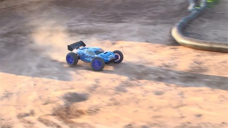

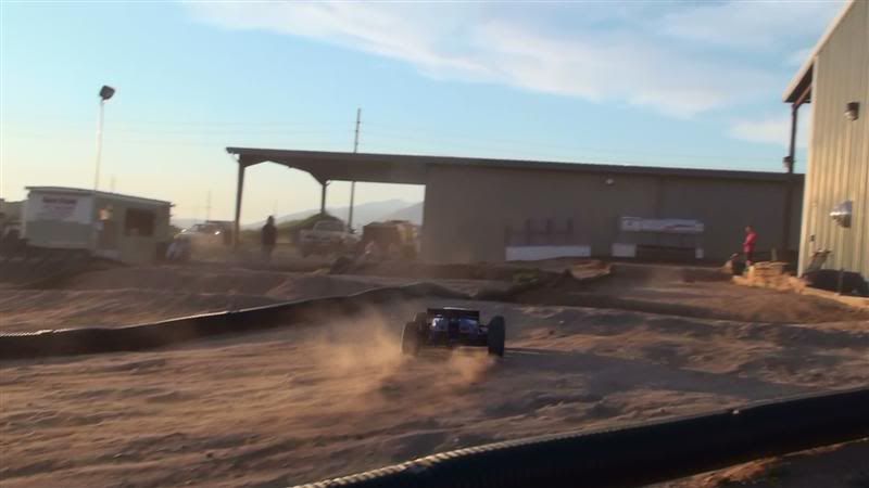

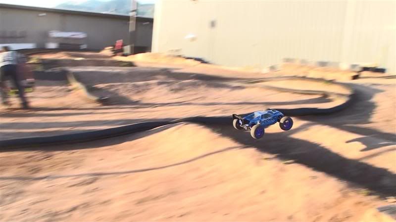

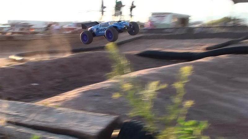

Here are some pics of his truck from the track last night.
I took the still shots from the video, so the quality isn't that great. It gets the idea across though. The first few shots are washed out because I had the backlight on. Oops.

as far as the Fioroni flex braces i LOVE them but be careful to run them with carbon chassis. when i first put them on i knew immediately that there was too much flex and that the carbon could break given the right hit. so the first week at the track with them on i drove really easy and everything went fine. i did a comparison with the flex allowed and then locked it up (you can lock the Fioroni brace so it acts like a normal aluminum chassis brace) and the handling was so much better with the flex. it was night and day. much easier to control and much more stable. and it was just absolutely "popping" on the jumps. had an almost spongey feel to it.
so this week i ordered some washers that i could fit on the flex brace and increase the tension on the spring so that it couldnt travel as far. my intention was to do this enough to allow some flex still but not so much as to risk cracking or breaking the carbon. when i finished i thought to myself "i should add a few more washers in there" cuz it still had lots of flex. but i was in a hurry and left to the track. needless to say i snapped the rear end of my chassis on a big tumble. no worries though. i have several carbon chassis' for my rc8t in the garage.
i am still going to run the flex braces but i am going to put more washers in them so that the flex is minimal. i actually have both my 8ight and RC8T setup now with composite brace up front and the flex brace in the rear. i am going to set them so they have about 1/8" of travel allowed. i had about 1/4" allowed when it broke.
so there is my 2cents. i know you are building that carbon 8ight with that expensive Matrix chassis so the Fioroni's are great but just get some washers and dial down the flex. btw, the inside diameter you want for the washers is 6mm. i found some on amain that said 6mm id. but they were actually like 5.5 when i got them so i used my dremel and reamed them out slightly.
for aluminum the flex braces would be awesome i bet. alum. isnt going to break for sure and i dont think there is enough flex that it would get bent so i think these would be a sweet upgrade on any alum. chassis. they make the biggest difference over rough terrain and jumps.
