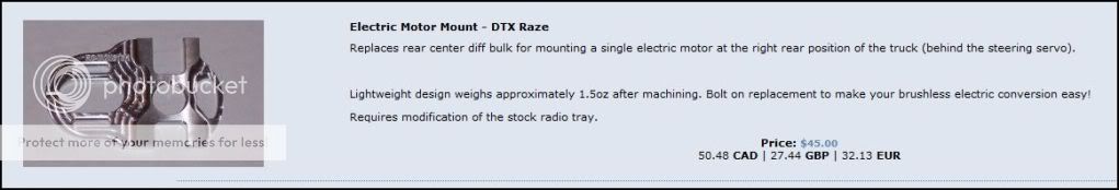

I see that there is a Brushless motor mount for the Raze here. will this work for the Raze ST as well? Should i think, because the Buggy and the Truggy use a lot of the same parts. What else would i need to convert to Brushless? Lipos are give, i was thinking about the EZRUN setups, with a cheap motor just for the time being. Thoughts? HELP!
06.13.2009, 08:47 PM
Yes the raze mount will fit on the st.

You will need a battery tray... the Rc-monster units are some of the best you can get
