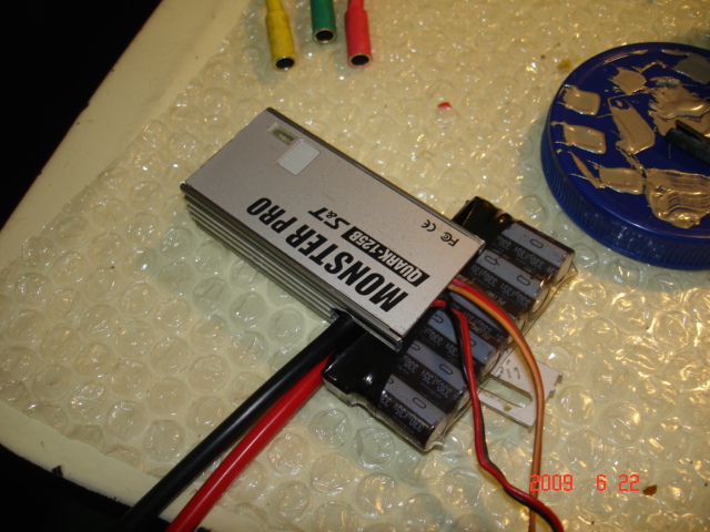

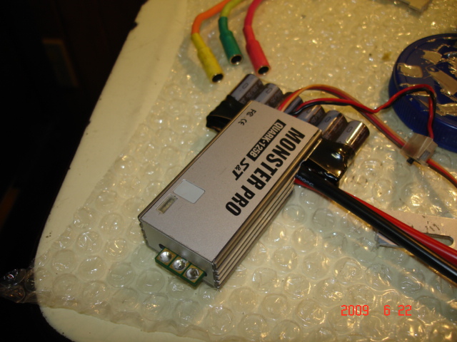

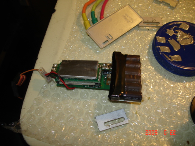

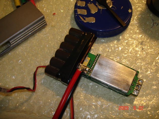

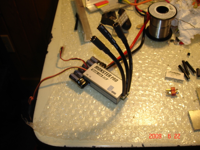

Hey guys.
Now I know lot's of you won't care, or some of you don't even know what a Quark is, or just forgot... but I thought I would post this anyways.
My Quark has been pretty good up until now, started glitching and cogging, and shutting down with my new 35C lipos when on the brakes for the first 5 minutes of running. I have a race weekend this weekend, so I thought I would do an overhaul of the Revo to make it 'race ready'. Opened up the Quark, and damn, the two caps inside the thing, the leads were simply melted off, so they were useless... only the outer two caps soldered to the batt leads were still good. Not good. Anyways, I thought I would do a few other things to make it race worthy. Enjoy.

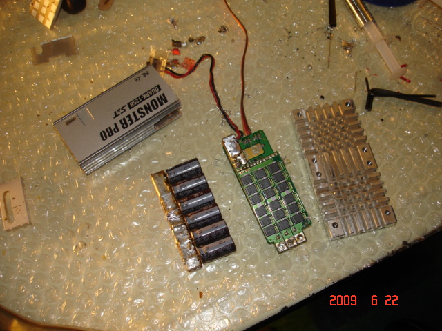

some more pics

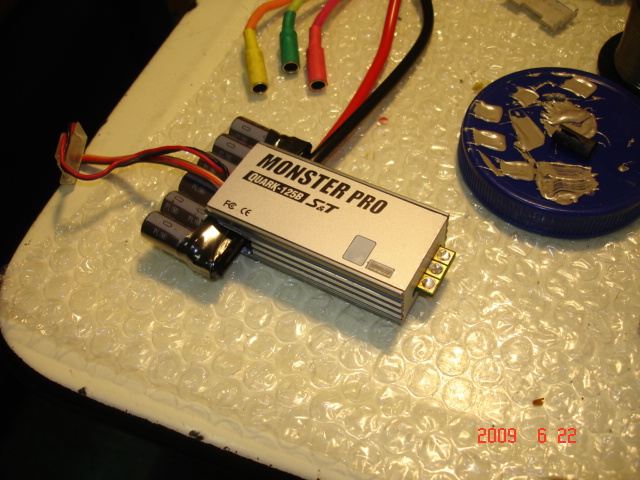

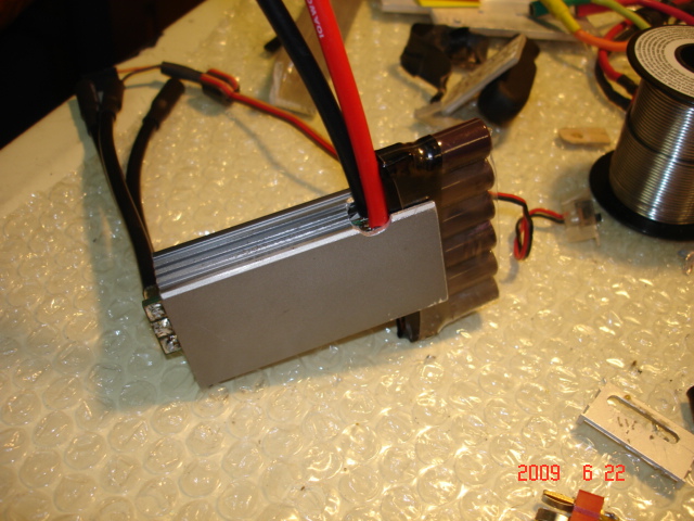

and an arse end pic
Wires are all 10awg... kinda ran into trouble with the input leads as it was pushing against the case, so I had to grind away a section so it would sit properly. Cap bank is made up of 6 35v/330uF low esr caps, the same cap bank from the "FrankenQuark". I also used thermal adhesive on the heat spreader as you can see.

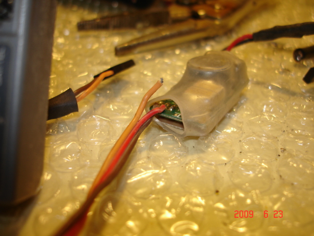

I'm using a PRO-BEC that S&T sent me the last time they replaced my Quark. Has worked perfect for 2 years now... I'll see what happens, I have an unknown BEC, and a Ultimate BEC I could try as well.
Okay, as I was typing this, I checked the BEC, one of the wires is brocken off... but it's the orange lead, which is not a power lead, and doesn't matter does it Brian?

No, the orange lead won't matter as it is the signal wire, which is not used.

Florianz, yes, caps make a difference, but it's not the size that counts, it's the low esr (equivalent series resistance) values that help the esc. That's why I have the cap bank right inside the case, soldered directly onto the board with a heavy buss bar. I would love to have some solid polymer caps to use on it, very low esr and small, and very durable.
My last Quark I modified, HERE, worked wonderfully, rarely cogged even geared to the moon, and ran super cold (most likely due to the heatsink it sat on, which actually increased to value of copper world wide when I put it in there, lol). It was too heavy, and was eventually killed because of physical damage from a hard crash.
