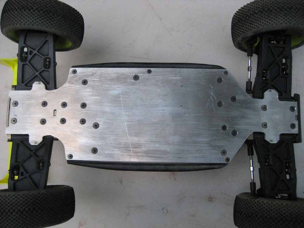

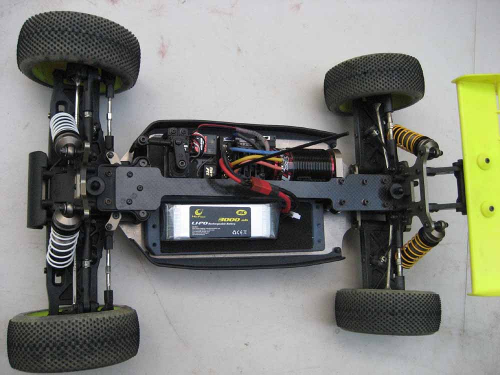

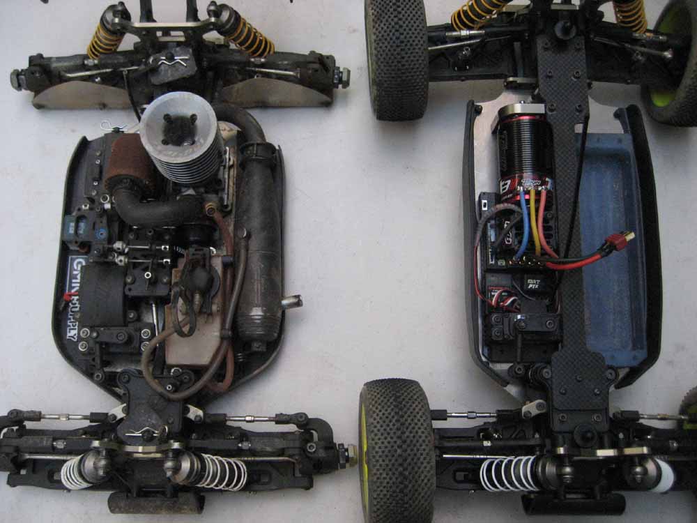

After 6 months of on and off work, and several false starts, I pulled an all nighter this past Saturday and finished my Hot Bodies D8E at 8:30 Sunday morning - and it was on the track racing by 11 that morning. I'm really pleased how it turned out, both in terms of how it looks, and how it runs. My original plan last fall was to build a 1/8th version of my Kyosho ZX5, complete with a center slipper in place of the center diff. After several months of work on the slipper, I abandoned that plan when someone told me the Hyper 9 nitro comes with a 40T center diff. 40T was the magic number, because a 40T spur was the maximum OD I could run and have the center diff mate directly to the rear clip. I started working in that direction, including new motor mounts and center drive shaft. Then, Hobao released the pictures of the 9E, and I decided to sit back and wait till it came out, so I could use that car's motor mount, diff mount and center drive shaft. I was also committed to run the new Tekin RX8 system, so I was waiting on that. In the meantime, I made the battery box, chassis (two versions before I got one I was pleased with) and a few other bits and pieces. I didn't need to buy a whole D8 kit, because I only needed the front and rear clips, so I just bought assemblies from kit parters on Ebay.

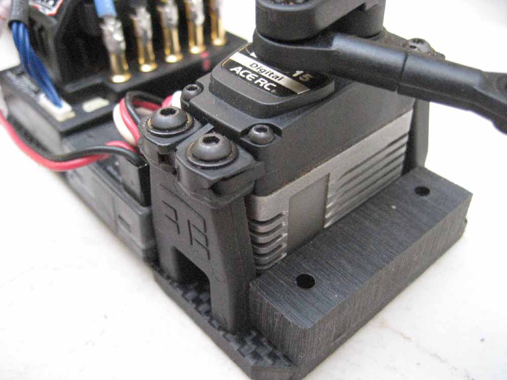

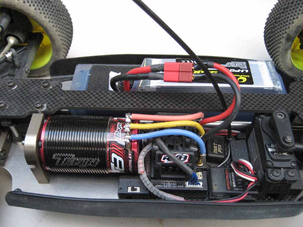

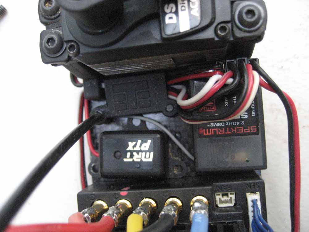

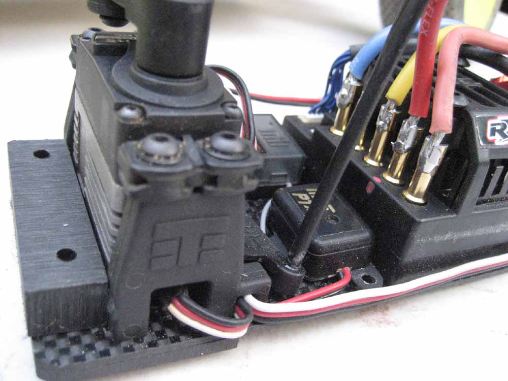

I spent the most time, besides the aborted slipper, thinking about how to make a simple, compact and easy to remove radio tray. After racing a number of nitro buggies the last 5 years, I really came to appreciate how easily the HB and Losi radio trays are to remove, which you do all the time with 1/8th buggies. At the same time,even the cleanest E conversions I saw looked harder to work on than the worst nitro buggy. I finally came up with a tray that holds all the electronics - even the on/off switch and radio antenna - and that mounts with only three 4mm flathead screws from the bottom of the car, with no nuts used. Disconnect the tie rod from the steering servo to the rack, remove the two 4mm motor mount screws, slide off the pinion, and then take out the 3 flatheads from the bottom and slide the tray out. Less than a three minute job - faster than any nitro buggy.

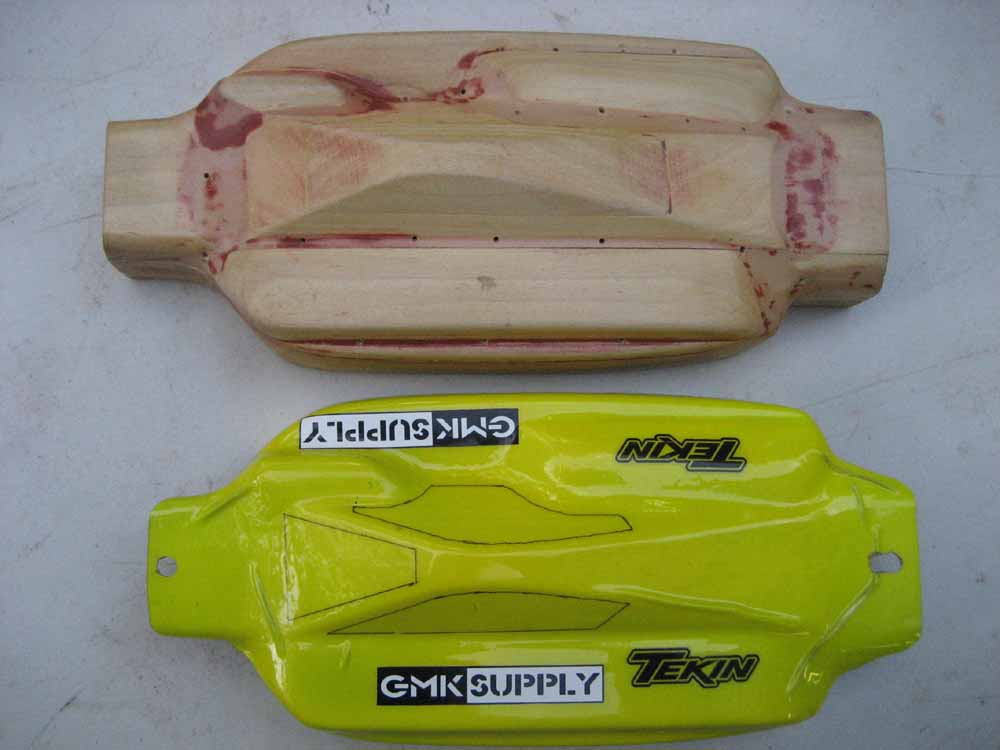

The car is really narrow, and I couldn't find any narrow 1/8th bodies. Even a body like a Losi electric or nitro is much wider than this car, which is only 5 1/2" wide from the outside of the mudguards side to side. None of the Hot Bodies team guys I talked to had an extra D8E prototype body I could have, so I decided to make a mold and vac form my own - another whole set of skills to learn. I still don't have a perfect cast, but I'm getting closer. 040 Lexan isn't easy to mold, so I may try PETG as an easier to work with alternative.
I ran it for the first time yesterday at a club race - I think there were 7 or 8 cars in the E8 class. With 3 minutes of practice, since I only had one pack, the car missed TQing by one second, and then went on to lead and win the 10 minute main - a good debut. I ran a Tekin 1700 buggy motor on a two 4000 35c packs - this club requires hard case packs, so I couldn't run my smaller lighter 5S. The Tekin system worked flawlessly. This is a very small track with moderate traction at best, so 4S was plenty - I worked on not spinning the wheels and staying smooth. The car was very easy to drive - with the weight so centered, the car rotated very well, and had plenty of steering. I only used 1800 mah in a 10 minute main with 30 seconds of warmup - only about 170 mah/minute. The motor only temped at 118, so I could definately go up a tooth or two on the pinion. I ran 15/40, with the HB 10/43 gearing in the diffs. 0 timing, 2 on the throttle curve, no amp limiting. The combination of the car's layout and the Tekin powertrain yielded a very smooth, easy to drive car.

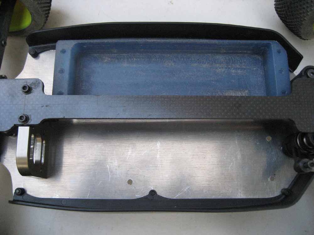

A few more details - the chassis plate is 3mm 7075-T6. The battery box is nylon, the radio tray is made out of 1.5 and 3 mm carbon fiber. The top stiffener and the battery box holder is 3 mm carbon fiber as well. With the two 2S hard case packs the car is 8 lbs 1 ounce; with the lighter 5S 300 30C soft pack the car is 4 ounces lighter. It is not a particularly light car - the HB clips are not light - but it feels light, is very simple to work on, should be durable, and like the D8, it feels lighter on the track than its weight would suggest.

Wow, a wood mould for a customized lexan body, Nice Job.
