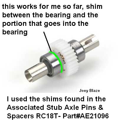

Originally Posted by blueb8llz View Post
so these micro t's can handle power and speeds? i would have thought their diffs would be incinerated.
The diff's need to be shimmed. Without some type of shim they will grind after a few runs on brushless and lipo.

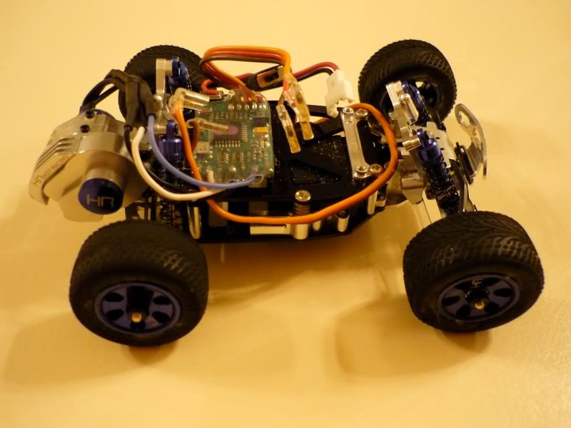

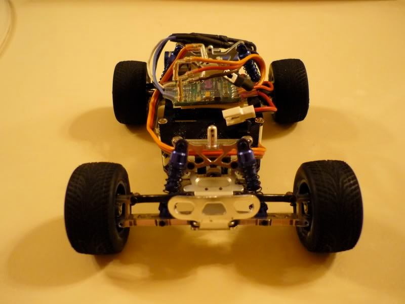

This was the Micro-T I had before I sold it. Used an SR3500 receiver, fit perfect, but kept it when I sold the Micro-T. Sorry about the poor lighting!
