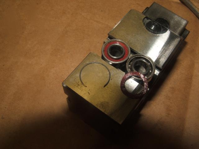

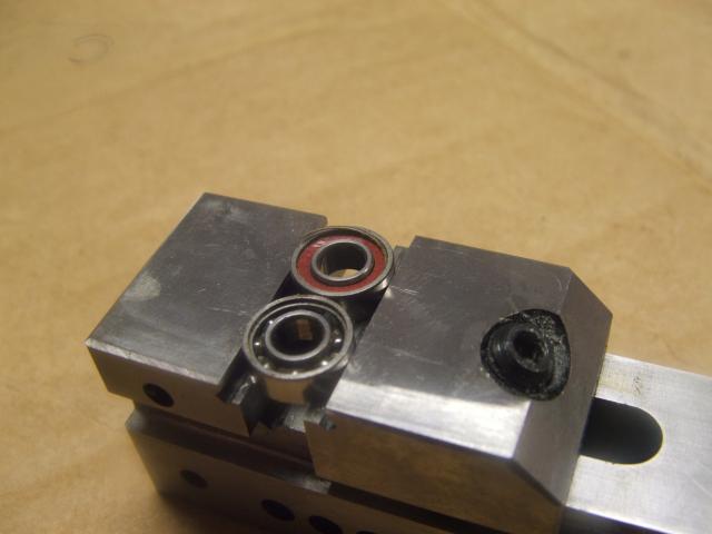

First I start out with the bearings as is. I use the vice to hold the bearing and the pick to remove the retaining ring that holds the shield in place. Do this by slipping the edge of the pick in the groove and hooking the retaining ring and pulling it towards the inner race, then slide it up and pull the ring out. Be careful as it can fly off like an E clip and it'll be real hard to find.
The retaining ring looks like a ring that has been cut diagonally. You want to slide the pick under the side that is sharp side close to the inner race.
Once you have the retaining ring off one side do the other side and other bearings. Remove the shields as well.

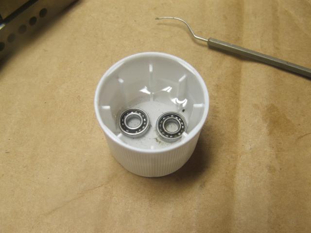

I used the cap off of the B-12 and filled it so that it would cover the bearings. I left them for a few minutes and shook it a little bit. While I was waiting I cleaned the shields and retaining rings, with a shop towel.
Take the bearings out and spray them with the cleaner you are using by spraying through one side then the other. Then I dump out the cap and place them back into the cap refilled with clean solvent. Remove them and spin them by hand a few revolutions and place them back into the solvent.
After that I remove them and spray them out again, then use compressed air to dry all the solvent out of the bearing.

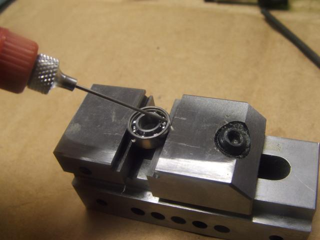

Using the pin oiler I place a small amount of oil at 3 places 120* apart in the groove of the outer race, then spin the bearing by hand a few revs in each direction. If you use too much oil it will leak out and cause dirt to be attracted to it.

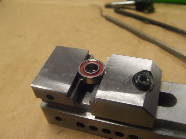

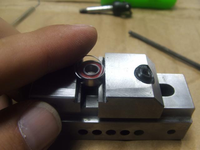

When replacing the shield set it in place and get it located into the bearing and use your pick to position it. Then take the retaining ring and slide the opposite side you took it out into the groove and slide it around until it is completely snapped into place.
