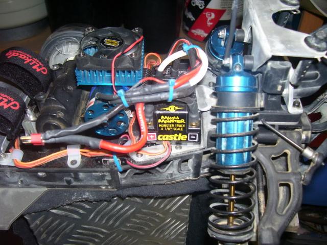

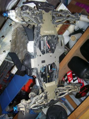

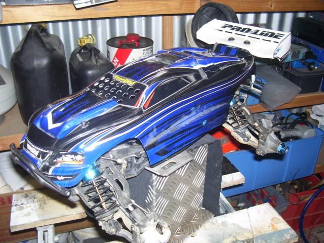

THIS WAS MY CONVERSION TOO......THE DUDE'S STUFF IS TUFF AS NAILS ,MY MOUNT WAS JUST A PIECE OF ALLY ANGLE AND IT HELD UP .
Upgrades as follows.
Forward only conversion
Losi sway bars
Losi black springs
Rpm arms
lundsford turnbuckles
Dynamite engine brace
New era alloy steering blocks
Mbx5t wing stay
Proline high down force wing
E-Revo body
Hd diff cases
Carbon fibre top chassis plate
Muggy shock towers
tini shock shafts
alloy shock caps
converted to single speed
(2)11kg mg995 metal geared servos
Custom made 30T Mod1 pinion gear
Medusa 36/80mm 2000kv motor
Mambo monster max esc
Large 50mm fan and heatsink.
THIS IS A VID OF IT WITH A FIEAGO 10XL ON 6S LIPO.........YEP... IT SMOKED AFTER 10 OR SO PACKS
ID:	7852   Click image for larger version
ID:	7853   Click image for larger version
