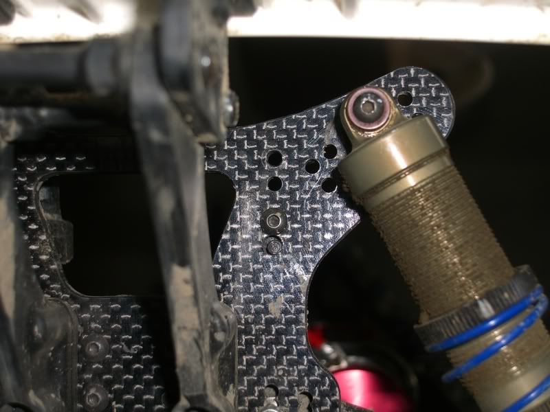

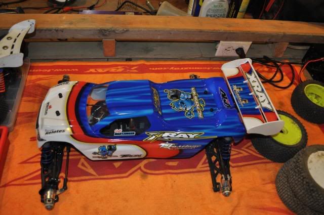

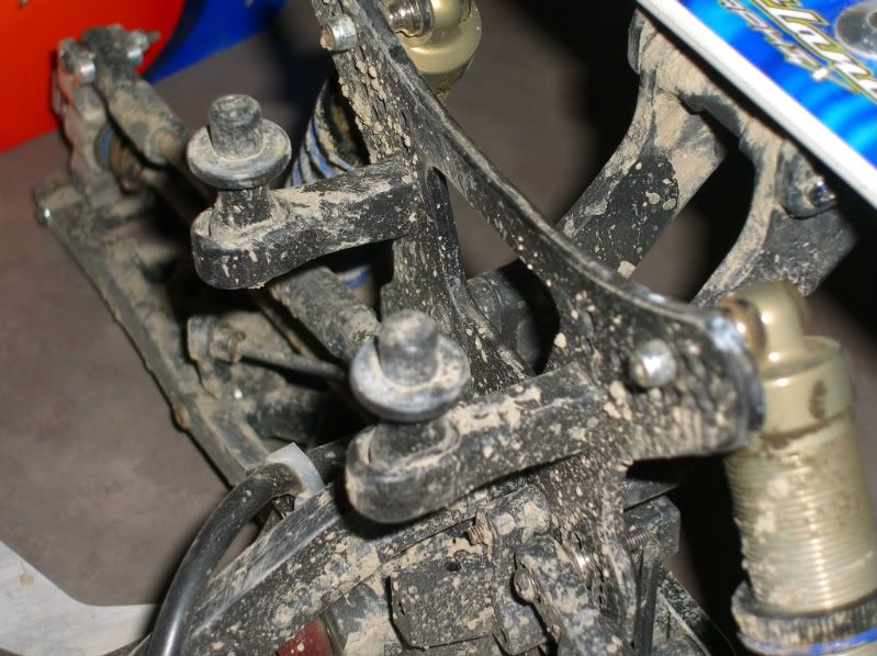

I use the Mugen MBX6T body on my XT8'09. Its actually a perfect fit if you use the Mugen rear body mounts. I had to drill new holes in the rear shock tower to get the Mugen rear body mounts in the right position. Here are a few pictures.
One with it mounted. Not a great shot but its the only one I have.
Showing the Mugen rear body mounts on the XT8'09 tower. Sorry for the dirt. Picture was taken right after a rather wet race day and it hadnt been cleaned up yet.
This one shows the position of the screw holes I had to add to make the Mugen body mounts work properly.

That looks clean and exactly what I was hoping for. So I am assuming that the 08 version xt8 will be similar set-up?? With the mugen mount?? Thanks for the assistance.

Biggest difference would be the older XT8 is arround 10mm shorter, but I would think the body would still fit fine with the rear body mounts modified.
