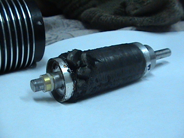

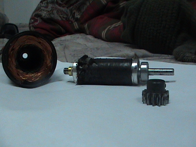

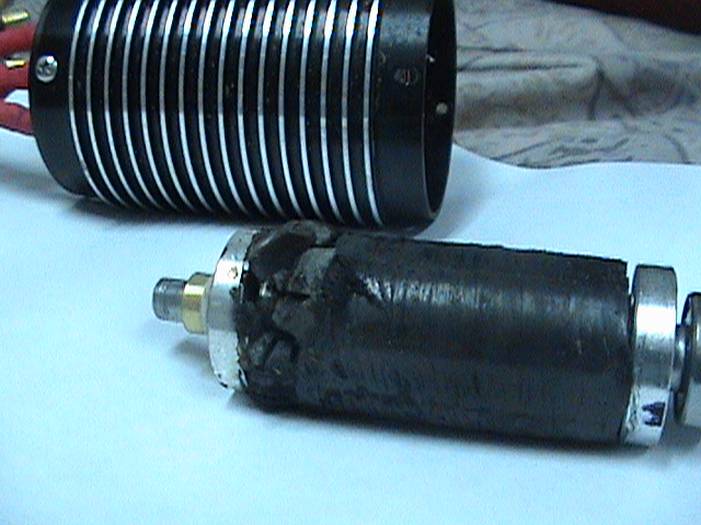

I'm somewhat a newbie to RC so bear with me. I have been having a problem with my Momba Monster setup. I currently have a v3 MMM esc and an equvlient motor to the one that comes with the e-revo BE, I am running a 5s lipo 30c 4000mAH (Eagle Power). This is installed on a Cen Matrix TR FRE, brushless converted with the rc monster motor mount. I recently destroied my second motor (pics below) the first one i was running 11/66 or 62 cant remember whatever comes stock on a the truggy. The second time I was running 11/52 motor temps were good and esc fan would never come on, also i was running with the body off, so airflow was not a problem. I mostly us the truggy for bashing and was planning to start taking it to the track but am now getting very frustrated... any help would be very much appreciated.

Guess that motor isn't equivalent. You blew the rotor. It didn't stand up to the RPM requirements.
Try a genuine motor next time. Castle/Neu or Neu.
Trying to save a few bucks can cost a lot in the long run....

What motor is that? totally different from Castle's except the cooling fins. No kevlar wrapping, carbon instead. The magnet doesn't look like neodymium neither. Stator/windings/leads/screws also differ. Same size bearing though.

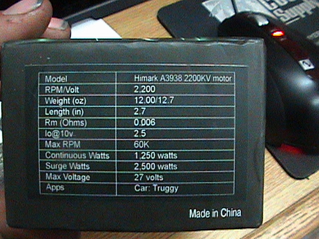

This is the combo set I purchased at the local hobby shop in Korea
http://translate.google.com/translat...3938%26hl%3Den
₩ 466 000 = 398.89600 US$

They quoted the CC website in their ad. The part about the ESC is fine but I think it was wrong of them to put the motor part in there since it doesn't come with the real CC motor. I think it would be easy for a less educated shopper to purchase that system, and, when it fails, assume that CC makes poor quality motors.

They say that the castle motors are "on the way", but then dont make it clear that the included ones arent actual castle motors... not cool.
And the price of $398 for a $170-200 esc and $60-80 is insane, thats just obscene.

So this isnt a CC MMM?This is a good copy?It says CC on the switch
