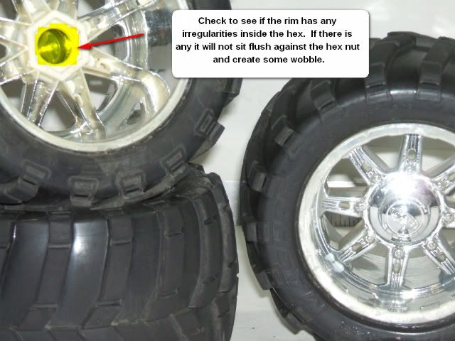

The inside of the rim where the hex fits might have a part that isn't as flat as the rest of it. I had one rim that always wobbled no matter which axle, hex, or rc it was on. I took a dremmel and flattened out the surface of the hex and it fixed it.

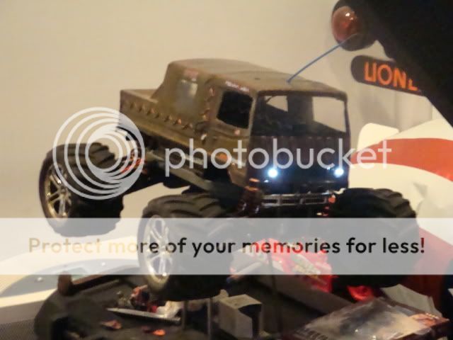

This happened suddenly. I just took it out one day and it started doing that. Didn't do any stunts either since it was a test day for my Dewalt motor. I always store the tires while flat with the inside of the rim on the floor or on the truck with it sitting on this stand I have. I don't think heat was the problem since they were always mounted since I used them more than the stock tires and were near the air purification thingy and was usually on during the summer. Is 80 degrees exessive for a room since that was normal temp this summer for my room. This did start during the summer. Pic-
[IMG][/IMG]
If you can see it there are three metal sticks all vertical getting closer to each other towards the top. They are screwed into a ring and the trucks center skid is sitting on that with the suspension not compressed.
