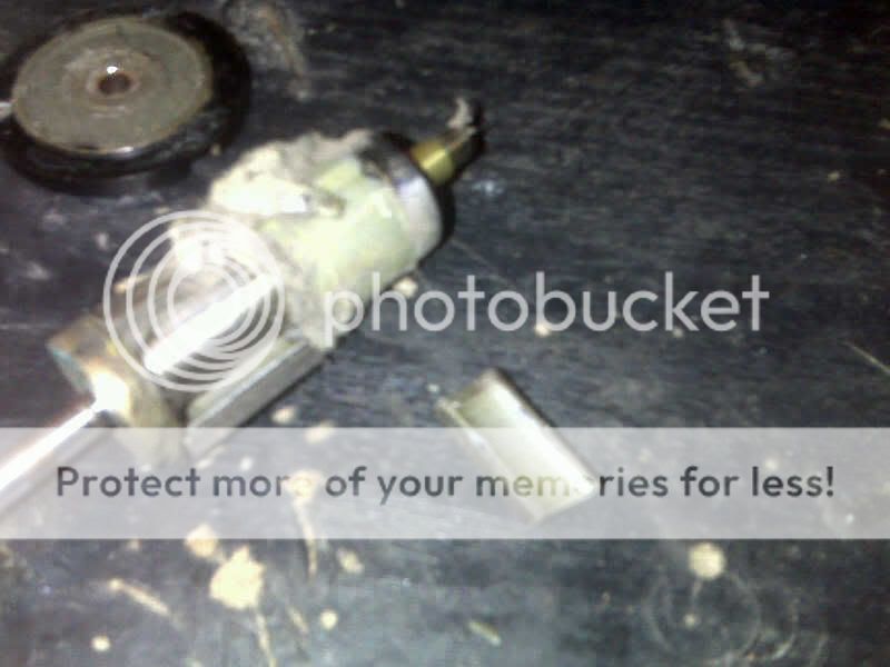

Well I was running my CC neu (2200kv) with my MMM on a track today. Was running strong for at least 15mins and all the temps where fine. 140 on the motor and 120ish on the MMM. My truggy was geared super low ( 8ight 9/48 (36mph on brianG's calc). All of the sudden it just slowed down and stopped. The motor began to just get EXTREMELY hot and had a horrific smell. I unplugged it and saved my MMM/6s. Lets just say it doesn't look pretty.
Would this be under warranty?

I think you were geared too low. However nice carnage!

Thats really low gearing. The last(only) other ripped CC/neu rotor i saw on RCM was warrantied.

Hmm, I thought it was a little low but not that low.. 36mph with no balooning and lipo at 3.7v per cell.. Aren't you suppose to gear about 40?

6s on a 2200kv motor is a lot of rpm. Also, the low gearing allowed to motor to really spool up.
I would guess Castle will warrenty it; you didn't do anything wrong.

36 is about what I have my RC8T geared for with a 1515 2.5D on 5s, with no figure for tire ballooning as well. I don't think it's to low by any means, when I geared up I actually ran slower times. For me 50/15 or 50/14 seems to be perfect on the track, with 43/10 diffs

I guess issue here is RPM on motor, not actual speed of vehicle.

Well isn't the 2200kv motor made for 6s use? Obviously it isn't ideal because 2200kvx25.2= 55k RPMS. How come they advertise the crap out of the ERBE and FLux running on 6s with the same motor.

Low gearing may cause heat, but if the system was running decent temps you were not geared too low. These vehicles still place a good load on stuff, even with low gearing. Big tires and lots-o-grip makes load. I would send it in, CC will warranty it.

That makes a failure rate of about 1 in 6500 motors.
We've actually seen a failure rate of about 1 in 2500. Pretty dang good for a 55KRPM+ motor.
Plus, we've watched the failure rate drop by about 70% since we first started making this motor -- we are getting better and better at making the rotors last...
Yeah - - What he said.
