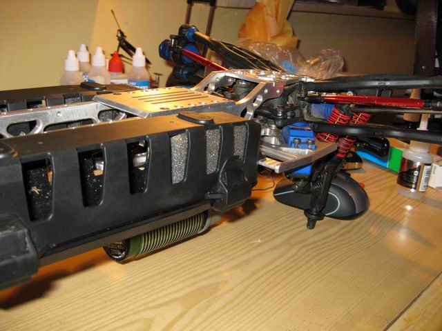

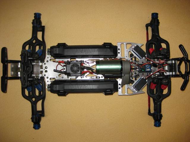

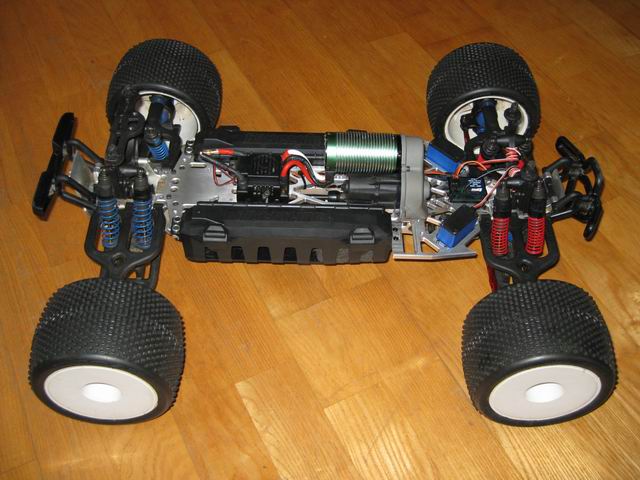

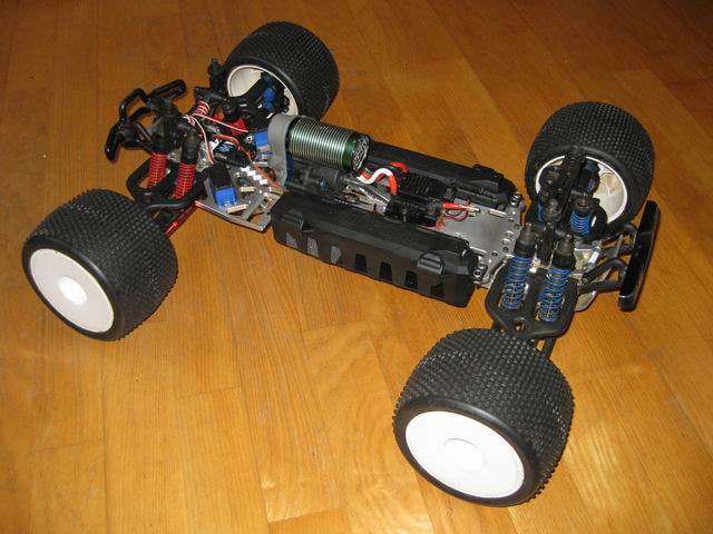

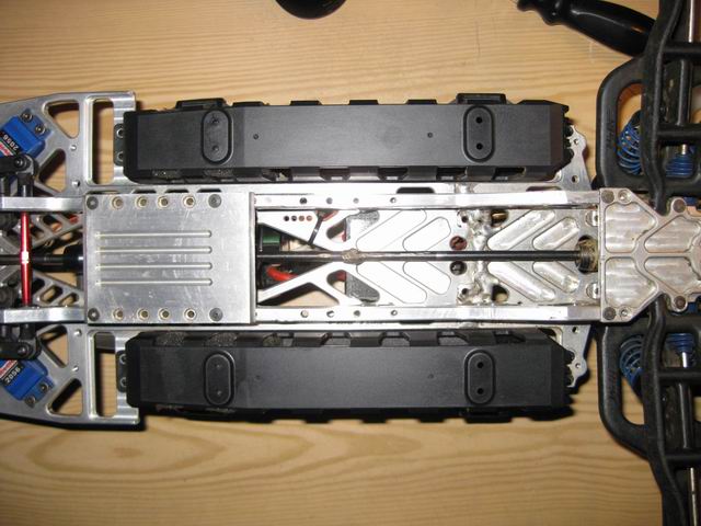

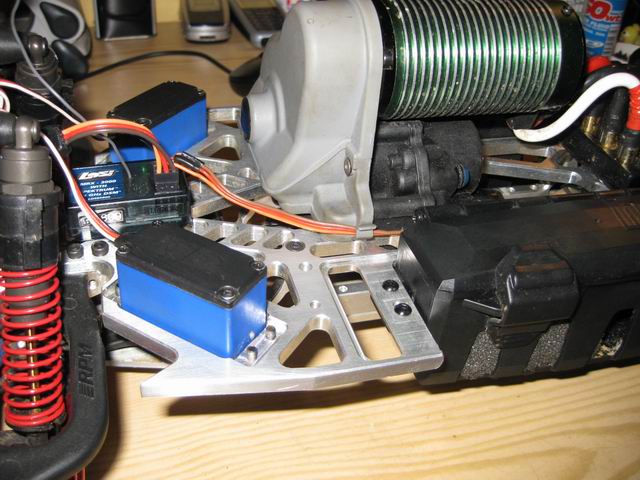

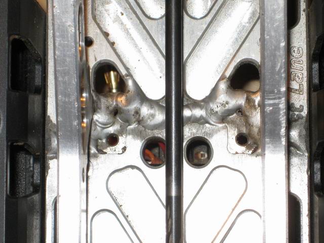

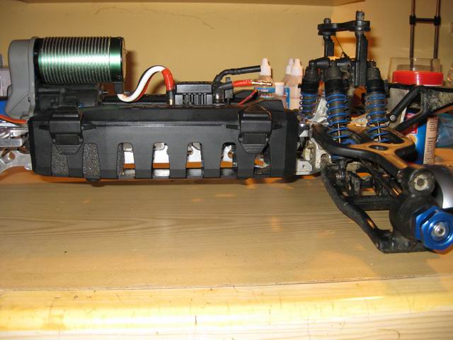

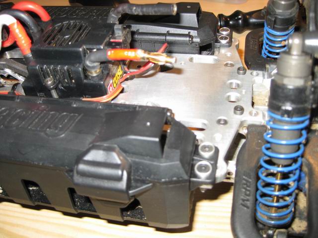

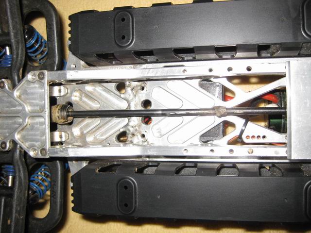

My name is Patrick and i come from Austria/Europe. I want to present my "Bash-Maxx" here in your forum.
My english is not very good, and so i will post more pictures. If you have questione i hope i can answer it.
Now to my Maxx. I took 2 FLM-Chassis and play "FRANKENSTEIN"
I make the Chassis longer for 6,5cm. Now the Wheelbase is 40,5cm (around 16") and i make the Savage Flux Lipoboxes on the Chassis. So the weight is lower and the Maxx is very easy to drive. Not always lying on the back after a fullthrottle an no rolling to the side when driving corners.
The maxx also have FLM Combo-Bulks, full RPM suspension and a CC Combo with 2200kV which i drive on 4s Lipo.
anough words, now to the pic´s.
greats from Europe
pako1979

That looks good!
What body do you have?
Any pictures where you compare it to a normal size E-Maxx?
Any driving video of this monster?
Are that 40 serie Bow-Ties ?
