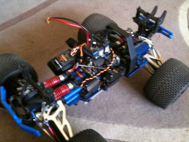

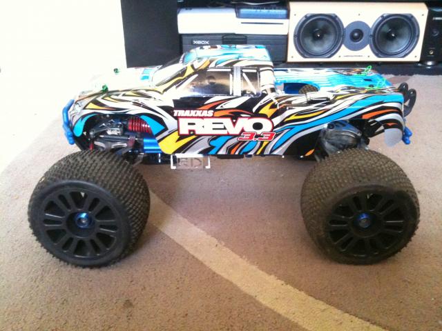

well got the revo up and working today with the 4s2p a123 pack i got with the car and the xcelorin 2100 combo "crap" running the tekno clutch and std brakes.
its fun just not fast not even close to fast ordered a new 5s 5000mah pack today and new set of wheels its running 23mm hexs.
crazy fun on wet road drift machine/boat think i need the sway bar kit

waiting on more parts just rush job to see how she goes

mbx1275
Posts: 47
Join Date: May 2009
02.11.2010, 03:13 AM
took the tekno clutch off today as my new long shank pinion came in the mail, all i can say i wow massive difference in power. i'm worried 5cell is going to be crazy

Manne
Posts: 163
Join Date: Mar 2010
03.30.2010, 08:17 AM
