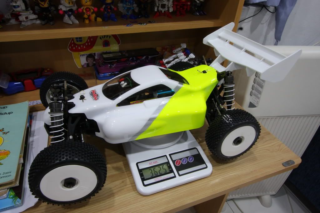

03.16.2010, 02:20 AM
Hyper 9e Medusa 4S, Savage 5S MMM 8XL, Jammin' 4S Neu MMM, X2 Ninja JX, X2 MMM 5S Neu, E REVO Medusa 6S

is that race weight? with all electronics?

I spy a MMM, a Medusa motor, and a Polyquest XP lipo. So yes.

ok... so i weighed mine and it weighs 4090... quite significantly more...
anyone know how that compares to nitro models currently on the market?
