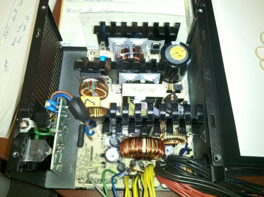

Here's the pic (sorry Droid pic).

I'm more concerned about the board listing 12v1 and 12v2 nearest the power wires. In the bottom of the image, you can see the yellow/blacks 3pair and the 2pair under those (to the left). The 12v2 is listed right there. 12v1 is listed nearest the 2x 4pairs above (to the right).

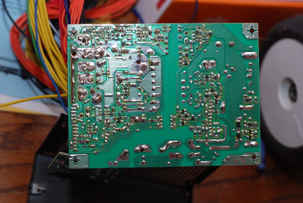

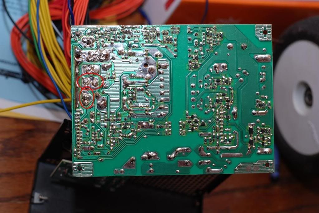

Alright, here's the bottom of the pcb....
12v marked with red circles.

Image without circles.

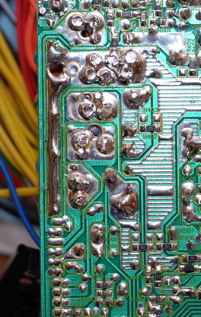

Close up of area...

04.15.2010, 10:03 PM
