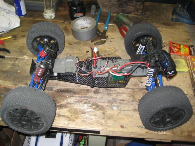

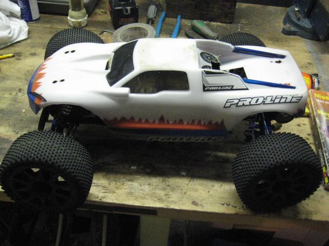

Here is my Rustler, completely overhauled with a Proline Revo Slipstream Body.
Hope you like!

looks great!
I did the same to mine but for some reason I could not get it running right.
Hope you got yours tweaked how you want it!

Thanks dude! It runs great and it jumps very well. only thing I'm concerned with is the Mamba Max gets pretty hot after a run, hot enough to where I can't hold my finger on the sink for too long I run 2s 25c Hyperion 5kmah, and velineon motor.
dont worry to much about the mm, it has thermal protection, if it starts cutting out then you may need to step up to 3cell and lower gearing

it is probably those tires that is killing your setup.. that is always what got my mm hot. once i replaced the tires with smaller ones it all went away..
as semi said.. lower your gearing and see if that helps..

Yea? I was thinking about stampede tires and wheels, but i love the way it handles with the 1/8 truggy tires! I'll try lower gearing first..
