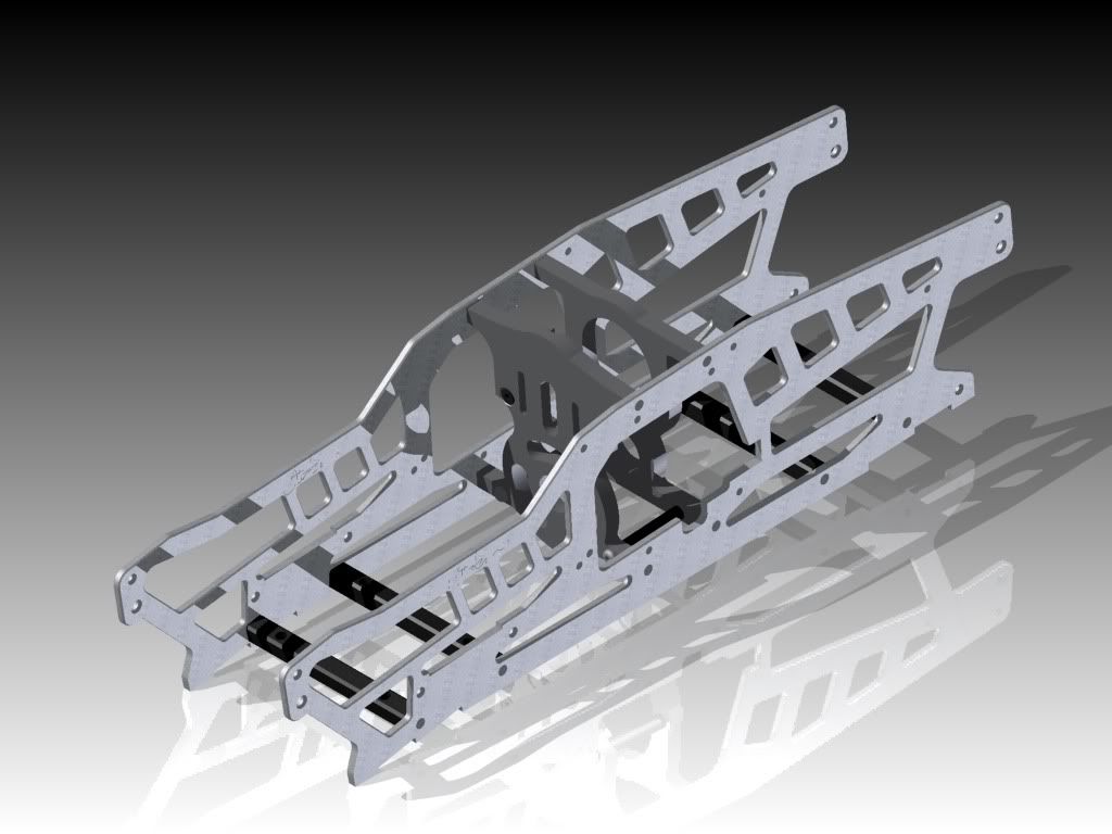

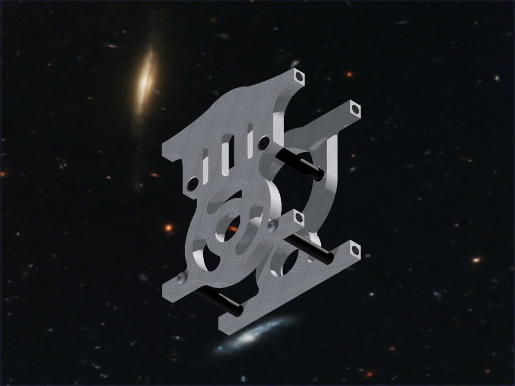

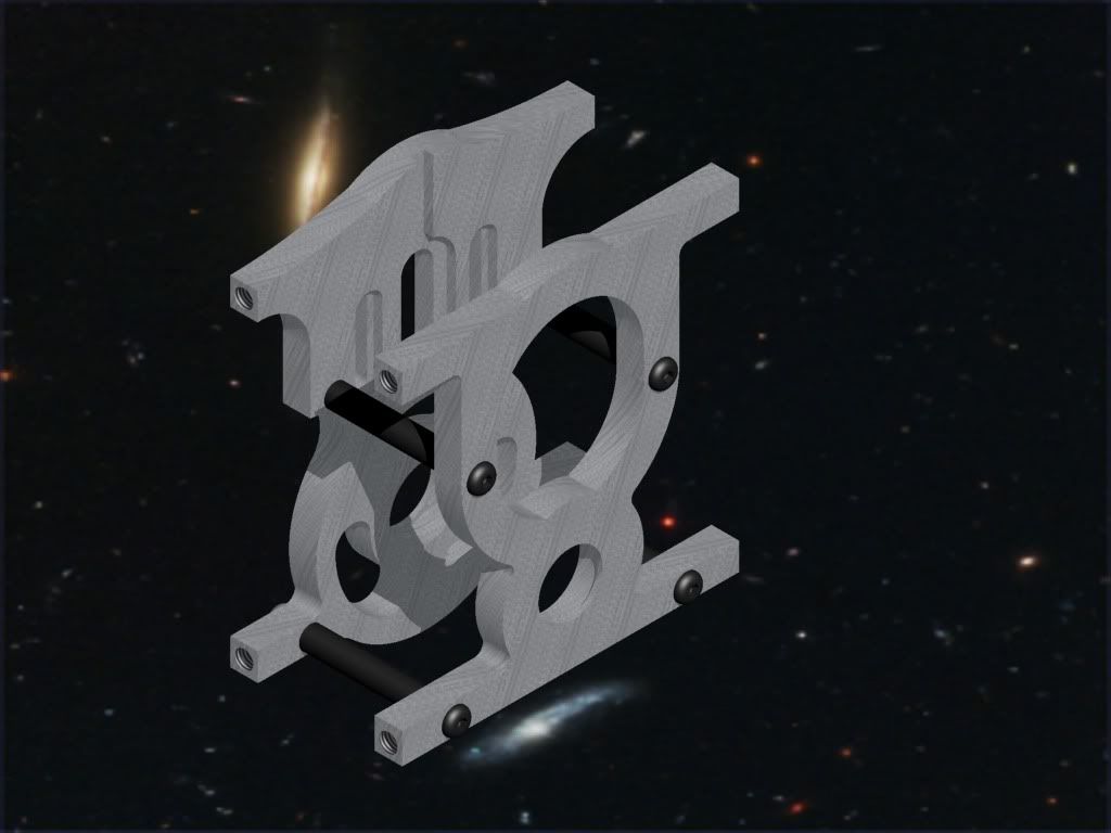

brushlessboy16
brushlessboy16's Avatar
05.27.2010, 06:31 AM
ahem...
Jahay
Posts: 1,007
Join Date: Apr 2010
05.27.2010, 06:39 AM
oooooooweeeeeee brushless boy... what is that you are mocking up? Looks pretty good... Uses the standard mounting points... And it looks very robust too!!!
Just one little thing... According to your drawings, if i am correct regarding the motor... You have to fit the motor first then fit the pinion? as the pinion cant fit through the hole already fitted to the motor shaft? Or am i looking at it wrong?

brushlessboy16
05.27.2010, 06:43 AM
Thanks, another member here asked for the same thing.. Slipperential mount for a savage.
You have to put the pinion on after the motor, its an easy thing to do, or i could tweak the design so you dont have to shoot me a pm if your interested

brushlessboy16
05.27.2010, 07:37 AM
I dont see the point to making the pinion slip through the motor mount, its a single set screw< 2.0mm driver, and it takes less than a second to do. Plus You would need a huge hole to fit anything over like a 13t pinion
