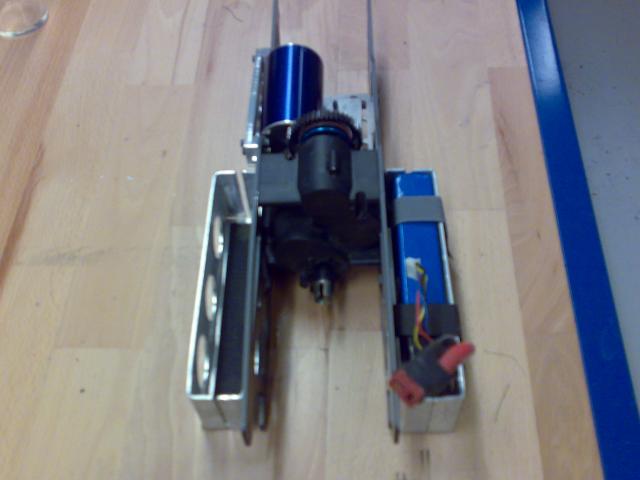

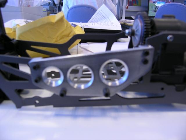

A few blurred pictures of my progress...
Ive got 9mm extra sideways room after modding the standard TVP a little. Plenty of room for a 45mm wide motor like the KB45-XL.
Its the weight optimized race edition... bolted onto the TVP in 6 places. Hopefully it will be strong enough.

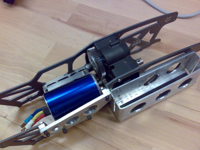

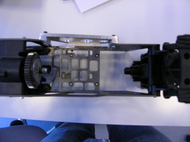

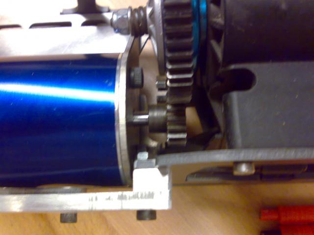

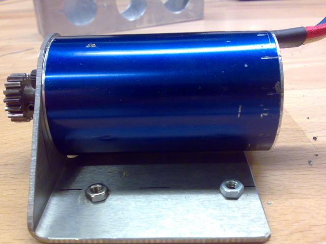

Some progres:
Motor mount ala Lincpimp:
Its 2mm HD steel... I couldn't bend anything thicker. In order to avoid damaging the thread I made in the steel sheet I'll add some M4 screws on top of it. Actually I could just have made some straight holes and added the screws after...
Yes it can wobble a little... a little :) I'll have to add some sort of support in the rear. However it can only wobble vertically. Not horizontally... so it should be pretty easy to fix.

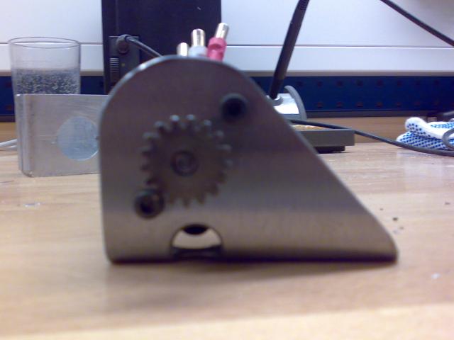

Drilled a hole in the bend line to get the motor as low as possible:
I can mesh 13-19 tooth pinions as it is:
Chassis with battery trays:
Tested it a little around the parking lot with the KB on 3 cells. looked good :)

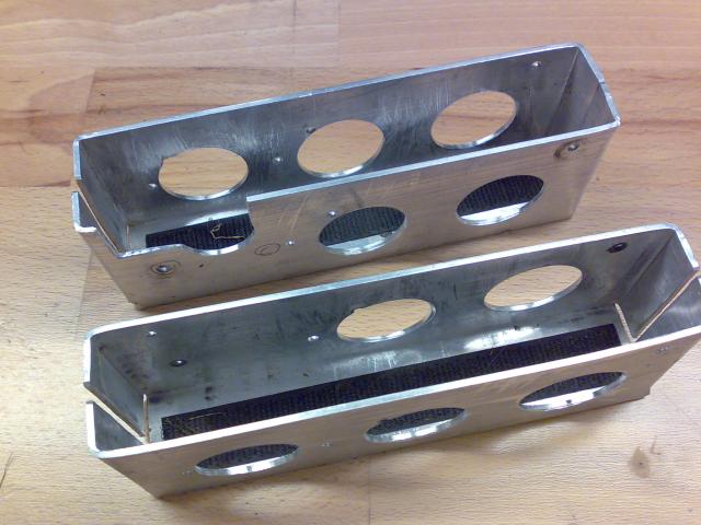

The alu battery trays... yes drilling those big holes did save me a few grams (and I agree it was a waist of time):
The cut out was needed to make room for the center transmission. On my previous E-Sav I had put washers in between the bat trays and the chassis to make room... but I wanted to skip that on this one.
The whole thing from another angle:
This has cost me a few hours of work... the materials can be found pretty cheap either at your local metal shop/smith or at a DIY retailer.
I know its nothing special... but I think its important to show that it doesn't have to cost alot to do a conversion. I'll update if/when I break anything ;)
