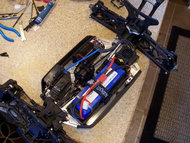

I must confess that i went down to the race completely unprepared for the buggy class, i built a new 2010 spec kit during PRACTICE and then spent the entire day of qualifiers dialing it in with the help of xray pilot Ryan Lopez, He brought over his factory 808E (B) version for me to setup the electronics. After seeing the factory kit in person it was as big of a dissappoinment as we all thought, the radio box is a PITA to get too and entire setup is not very maintenance friendly. Ryan even commented on how much better of a setup this is. Thank goodness we have mike to build our conversions the way they SHOULD be built.
agian this is a first version, the radio box as small as it is, actaully has my rx and transponder inside. the car now has an Rx8 i got from Randy Pike a the race and has an Airtronics servo. I'm sure most will notice the rear chassis brace this was done quickly just for my car so im not entirely sure what the production setup will have. It uses the stock front chassis brace. But you definetly wont be bending any rear center cvds anymore.
so here is the teaser pic.

Thanks for posting the pic! That looks awesome! Now I know what to save for after I get my truggy dialed in!

Is that a losi Smart diff?

nope just an xray center diff with a AE 46t plastic spur. (if you do this remember to use the AE diff o-ring on the spur side as the xray one is too small OD)
btw smartdiffs/ activediffs and brushless do not work worth a damn....

Any chance we could see more shots off the car!?!?! jesus the suspense is killing me!!
Im so upset with the tragic death of my 808 main chassis and now i got ants in my pants for the RCM chassis!!!!
rootar
rootar's Avatar
Posts: 1,803
Location: arkansas
07.15.2010, 03:59 AM
its located right there in the middle
