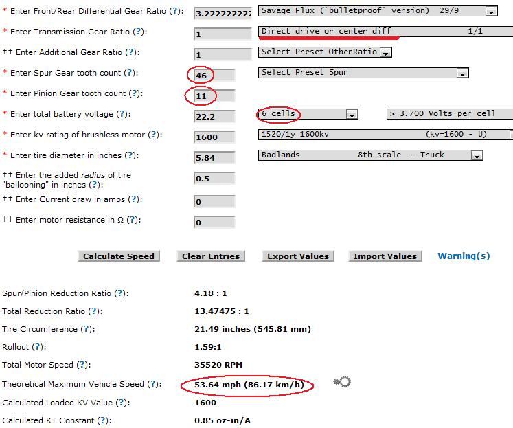

I just want you guys to check that my gearing is correct before i buy the wrong pinions. I am just a little confused as it looks ill be using 9t-11t pinion to get my desired speeds... Smaller than i have ever used (never had a centrediff)
Does this look correct? These are the speeds that i am running now with my current 18/47 gearing, and with no heating issues etc... so i am looking to maintain these speeds with the centre diff....

2.- That gearing is correct. A transmission offers the gear reduction you need for a good spur/pinion combo, but adds a weakpoint. A CD eliminates the weak point, but doesn't have the gear reduction necessary for an ideal spur/pinion combo. But it will work!!
