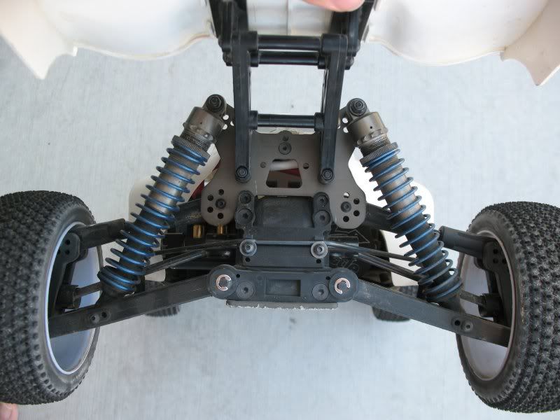

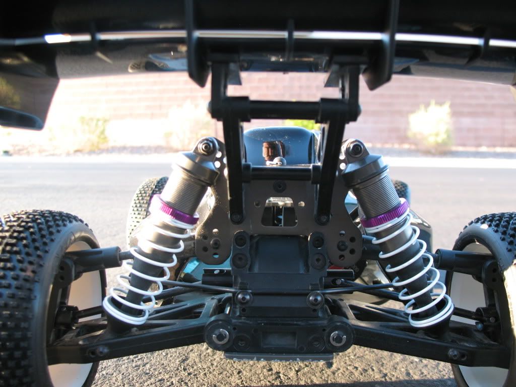

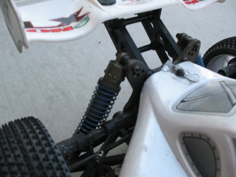

Pics... Fronts installed... rears shown for size reference...
Shock kits come with all hardware needed for the swap.. its just 2 inserts...

Got the rears installed.. ended up using 35wt Losi front and rear... feels really nice.. I'll have it on the track tomorrow.
DrFizz2k1
08.14.2010, 11:00 PM
10,000X better than before.. OMG!!! This buggy, (with proper tires) can easily be quite competitive... these shocks are the PERFECT upgrade... totally a different buggy... just phenomenal..

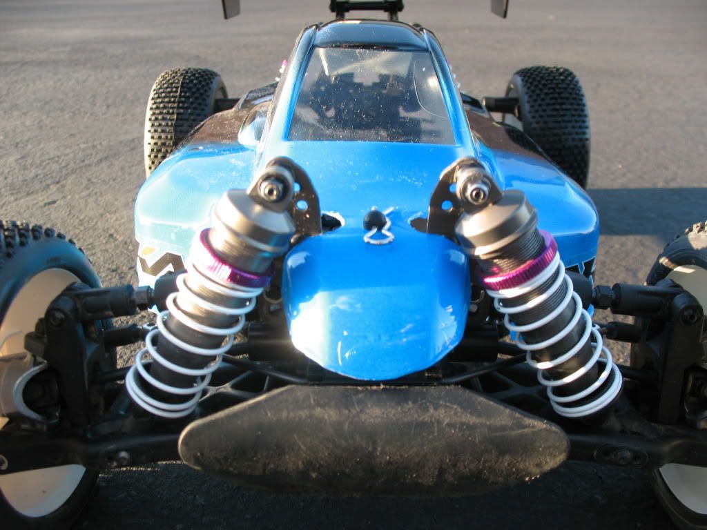

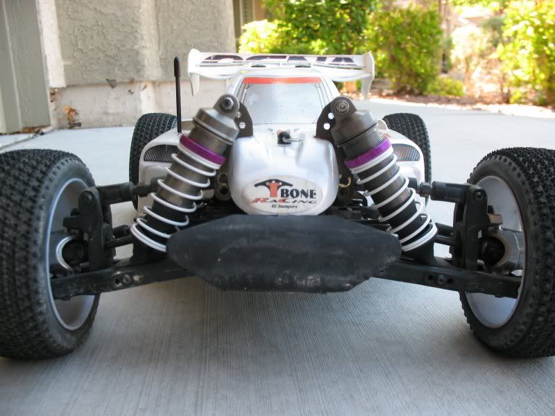

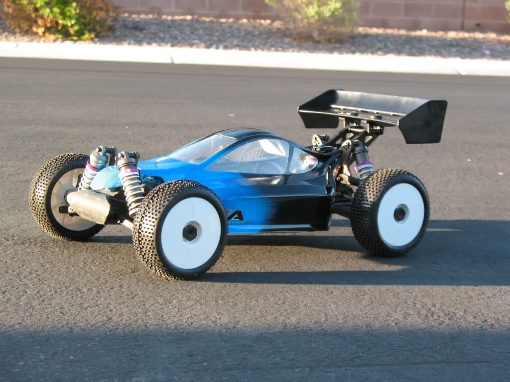

DONE!!
Well, it's been done a while.. but just got it track worthy again...
re filled the shocks with 35w Losi all around.
Re-packed the diffs, 5k front and rear, 70% 5k, 30% 50k in center.... it blends to equal about 10k.
New shoes.. AKA I-Beams, "soft"
New wing (RC8e)
New body... 11 bucks on ebay.. LOL.. same auction is now 29 bucks.. weird.. i scored though... :)
I was going to match the paint fade to the ring on the shocks.. but the paint color ... the can i mean.. its was no good.. just spit paint on my floor... so.. it ended up getting what i had laying around... florescent blue and metallic black...
FRONT:
REAR:
Full Monty...
