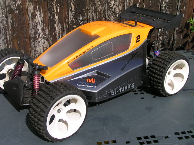

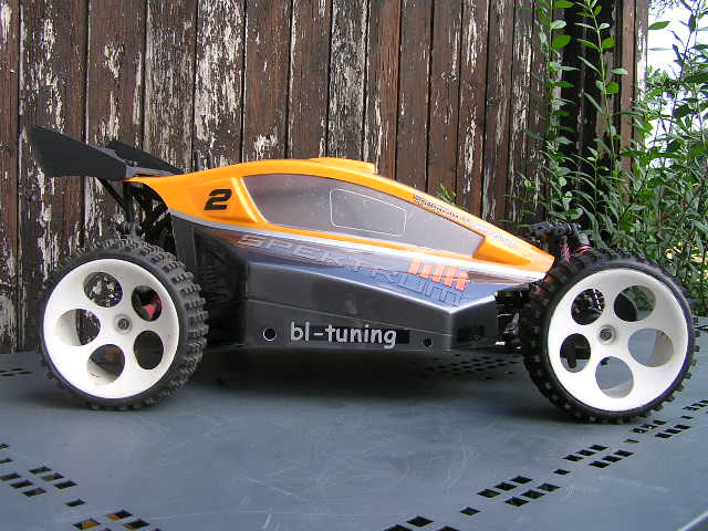

I thought this might be interesting for those of you thinking about moving from 1:8th scale to something bigger without wanting to lose performance nor 4wd.
First of ... yes it's possible and a good friend of mine made this dream come true.
Chassis: FG Monster Truck with 4WD conversion kit
Tires: FG Baja Buggy
Body: MCD Race Runner V4
Motor: Lehner 3014/18
ESC: Schulze 32.170
Batteries: 10s SLS 4000 (final step will be 10s SLS 5800mah)
Video of his 1:6 ride
Moving around 26.4lbs (12Kg) this way takes around 1200W average (550mAh per minute or 32A avg).
I hope you enjoy the performance of this car as much as i did while shooting this video.

09.20.2010, 06:17 PM
@suicideneil
Music: Training theme from Rocky IV ;-)
@redshift
Just got those pics with painted body.
@magman
Can't tell you how they compare to LST shocks but i found a video of his car showing the original setup with 8 shocks and chassis braces. He did not use those super big monster tires (wheighing 777gr or 1.7lbs each) on this run as they did not provide enough grip on gras. He was forced to run much smaller Buggy tires which hooked up pretty good.
So here is the video of his car running with a 26ccm petrol engine showing the original chassis with 8 shocks
@overdriven
Now that you mention it. He said he was using upgraded diff cases.
