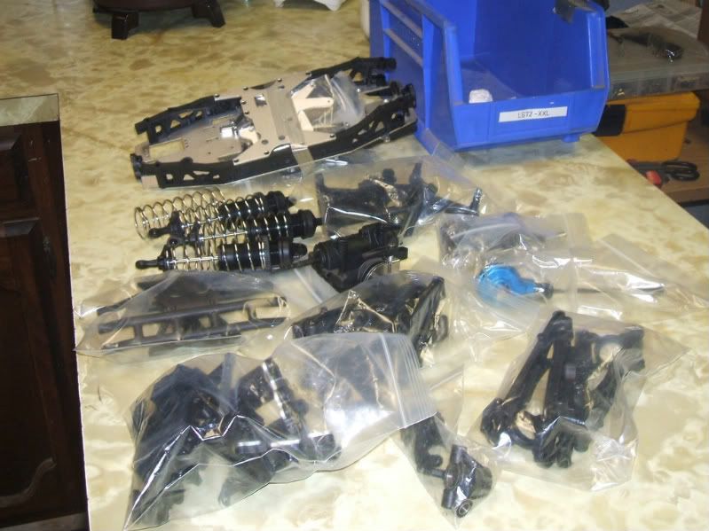

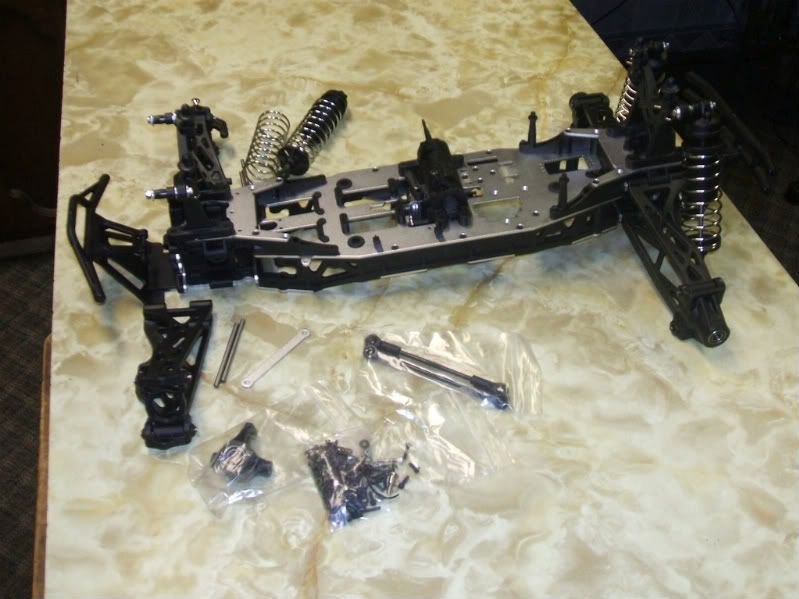

I started buying parts to make a XXL almost a year ago it seems. Got distracted, shocks ended up on the Sav Xl, used the diffs in the G3R, bought a LST2, sold it, moved on, forgot my name, and somewhere along the line lost the track of time. Well I found the track and my house again with a box of XXL parts so off I go again....
I may flip this before completion but with what I have on hand now I will be using a mm/2200 setup on 6s.
I picked up the axles and some misc parts in the first round of auctions the other day and going in for the rest of the parts in round 2 of the auctions soon. I was hoping for some clarification on some stuff before I start bidding.
Is it just the hex in losi rims and thier hex hub that are 20mm? Are the axles/cvs standard 1/8th size where other 1/8th 17mm & 23mm hubs work on the axles?
Will I need to pick up the linkage/servo horns also. I would think that a single high torque servo would be fine. Or should I stick with a two servo steering setup?
Has Mike made a motor mount or is The Dudes still the one on the top of the list as far a buying one already made?
Is the Losi Spur and Slipper Clutch the best way (only way) to go for gearing the LST2?
The LST I had the brief encounter with earlier this year was just that brief. I can't even remember her name let alone how we ended up in the same bed but ..... It looks like the Losi 2 speed is external to the tranny. I never had much luck with a brushless when it kicks into second gear for long. How does the XXL hold up gear wise? Will I need to pick up a clutch bell and adapter to run it with the 2 speed tranny? ....or.... For go that pita and convert it to single speed right of the bat?

You can use 17mm and 23mm adapters. But losi 420 wheels and tires are super cheap on ebay.
One servo is enough, the problem is the very weak servo saver. I plan to take the spring off 2 extra servo savers and put them all on one servo saver on a single servo (3 springs total) They just pull off and can be slid around one another. There is just not enough room between the top and bottom plate to use a better saver and linkage. So, yes, buy the servo savers and linkages, and either use the double servo setup or stack springs. Linc has done a muggy steering setup on an lst if you want to search
No RCM mount. The Dude's is top dog. Losi makes their own LST mount now. Search ebay for e-lst and electric lst
Yes, losi spur and slipper
The Dude makes a single speed hub adapter, the only way to go
Everybody knows red is faster
Just ebay better, get parts and beer.
