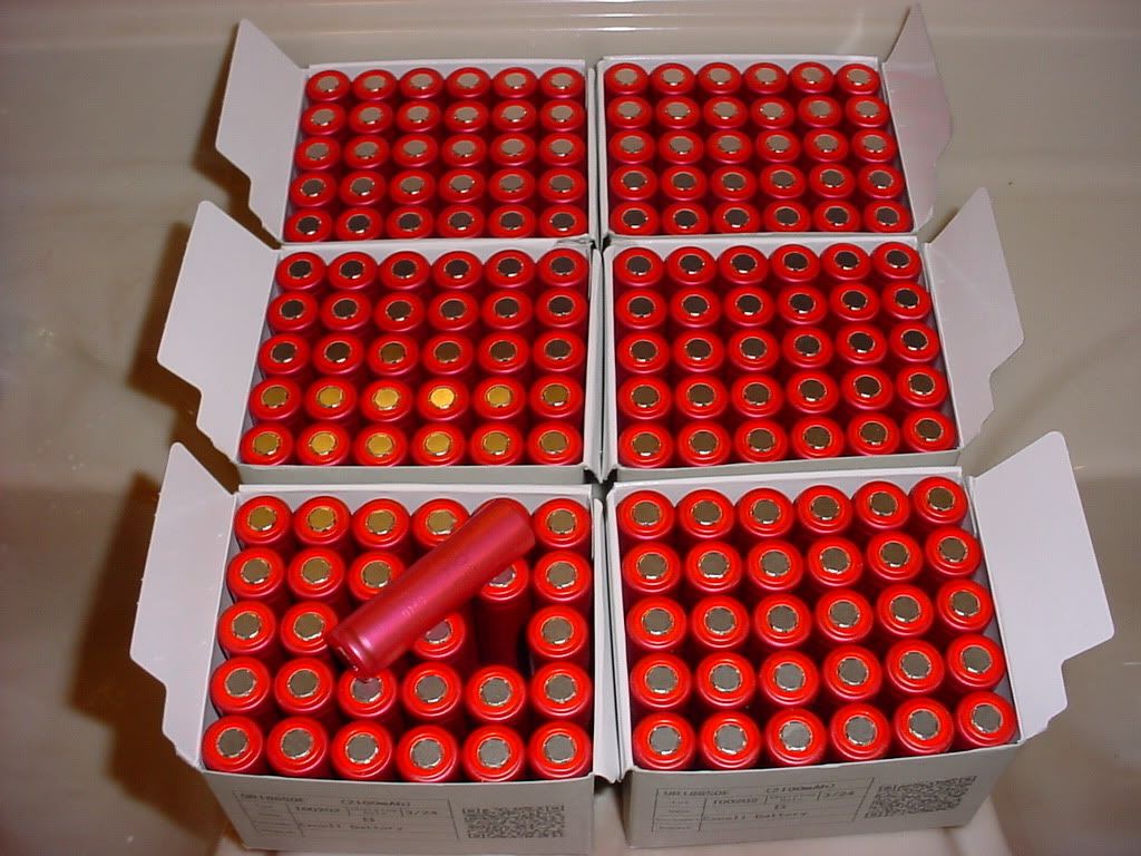

The pack itself is going to be constructed from New lithium ion 18650 cells. 180 of them to be exact.
180 Sanyo 2200mah 18650 cells, working together in a 6S30P configuration.
This will make for 66ah at 25.2 volts fresh off the charger. For comparison purposes, this will be equal to 130ah+ at the operating voltage.
Check this out. Aren't they pretty?

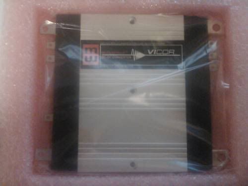

We're going to use 5 DC to DC Vicor voltage converters that were recently acquired.
Input voltage range is: 18vdc to 36vdc Output voltage: 13.8vdc @ 200 watts each
A couple of things I like about these converters are:
At 200 watts each, they will be paralleled for 1000 watts of total output. They will handle the load, since at maximum thrust, (55 ft lbs) the motor's output will be around 700 watts.
80% to 90% efficiency. I'm hoping to reach up toward the 90% mark, hence the total wattage headroom.

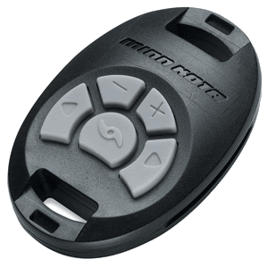

But then to add to the complexity of this conversion, I bought the wireless co-pilot add-on.
The co-pilot add-on allows the user to control the trolling motor wirelessly from a control that is worn like a wrist watch.
I wonder if the circuits inside can be isolated and separated? If the Co-pilot uses pwm as a means of speed control, using the MMM to power the motor might be possible. I'll have to do some more research on this.

This gives me some interesting ideas. OK, here's my "radio".
Center button, ON-Off Left-Right of course for steering. There are 10 steps to speed control. + and - are speed increase and speed decrease.
I wonder if there is anyway to match a receiver to the output of my "radio".
Then a simple BEC to power the receiver AND the steering servo.
If it were possible to match a receiver with this, then the rest of the controls might be worked out.
12.22.2010, 10:53 AM
I don't think so, not without some serious modding. Typical AM/FM receivers simply modulate the needed 1ms-2ms pulses onto the transmitting frequency, it is highly unlikely that unit uses the same method. I think it would be easier to take the output from that unit's (the one pictured) receiver and convert that instead, but still not a simple task.

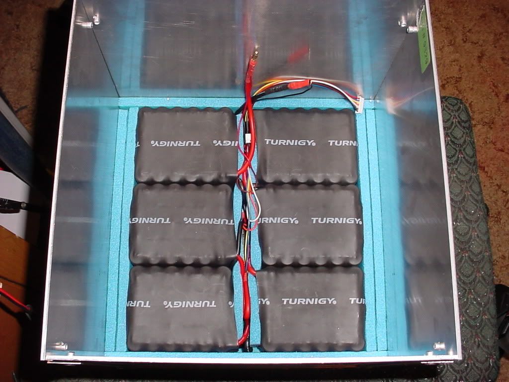

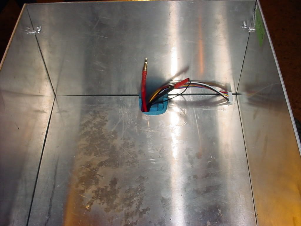

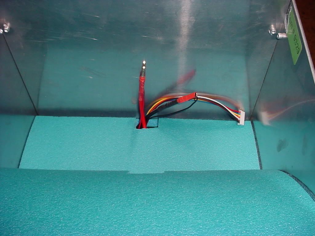

Housing will be a 1/8" aluminum box built out of sheet and 1" x 1" alum. angle.
In the bottom are the 6 individual packs of 30 - 18650's. I found some shrink that worked really well with them. All leads are 10Ga. Silicone, so there shouldn't be much resistence in the power line. And of course, we have our balancing lead.
Each pack is connected to it's neighbors using 4mm bullet connectors. This makes it removeable and can be configured in a number of ways.
This configuration is for 6S.
To add some cushion, I located a camping matt at Wally World pretty cheap. 2 layers of this surround the packs, then a "lid" is placed on top of them to create a "floor" for the electronic compartment.
