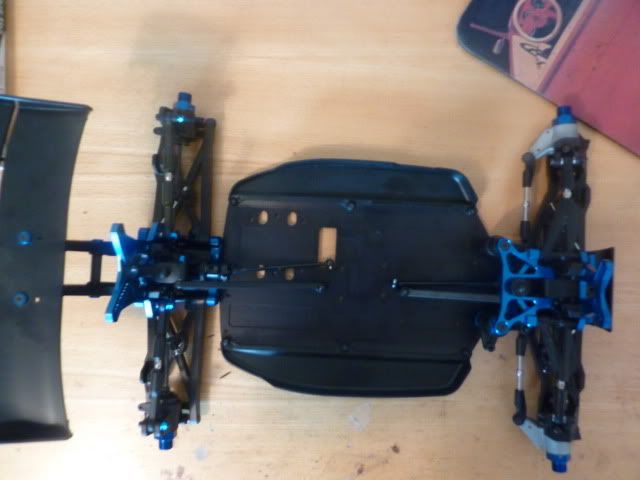

Front and rear is assembled! Waiting on the 1900kv tekin system, and for the gt3b recievers to get back in stock :P
Painting to body too! Gonna be a realy simple job..

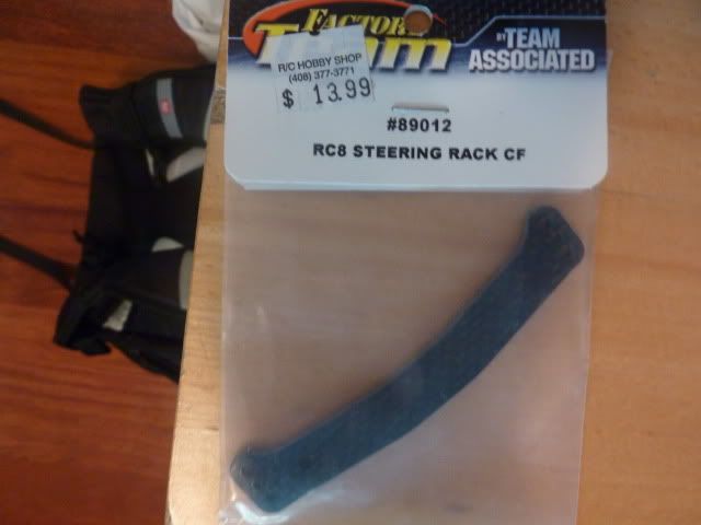

oh yeah..wondering..
About chassis braces, my track mates say that the plastic ones aren't too strong..
But there are two different kinds,
Ones that are aluminum
and ones that are like turnbulckes..
Whats the difference?

Plastic ones will give a little more traction in the rough stuff by letting the chassis flex front to back and torsionally a little. They are inbetween the turnbuckle type and cnc'd type. The turnbuckle ones will not allow much front to back flex but still allow torsional flex(twisting of the chassis) the aluminum cnc'd ones won't allow flex in any direction and are better for smoother hardpacked tracks like the ones here in socal which are indoor and clay. Hope this helps.

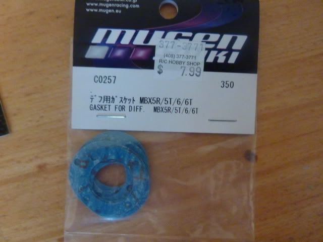

I am..Just installed it..and it's leaking..I heard a common fix is,
1. Making sure you have the newer updated clear o rings,
2. Mugen Gaskets (0257 i think was the #)
3. Sanding the diff cases where they meet.

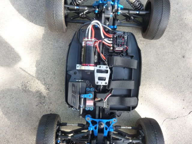

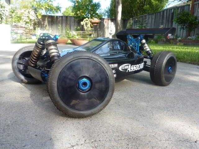

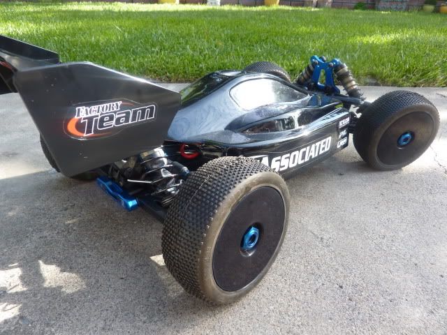

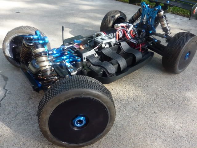

Pics as promised!
Never liked painting black bodies..but I had 4 bottles of black leftovers..so I got lazy..but it came out nice :)

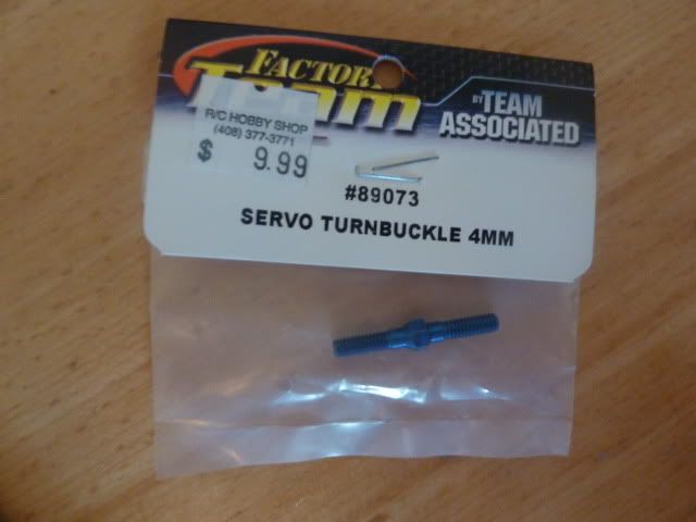

05.09.2011, 01:35 AM

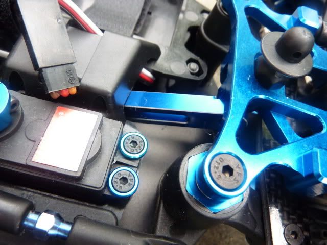

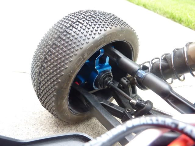

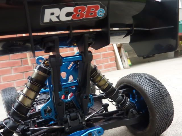

Update:
-Aluminum wig mount braces/spacers
- FT aluminum front hubs
- FT aluminum rear hubs
-FT front chassis brace
- FT rear chassis brace
