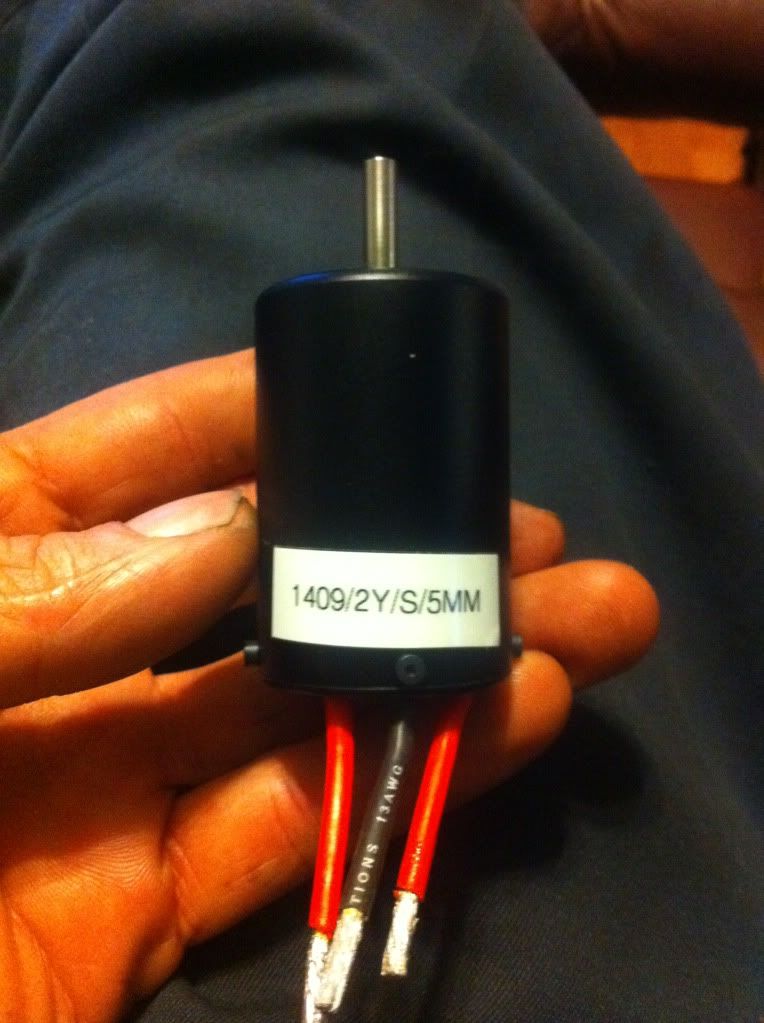

Got my motor a day early FedEx pulled one out of the hat
I'll get it installed tomorrow

Where did you order it from ,that it came that fast. I thought they were built when ordered.
I was wondering the same thing!? The one I ordered took 11 weeks, direct from Neu.
04.28.2011, 11:17 PM
Noodle wire looks odd too - Seems to say creations and also doesn't look to be ext of motor windings... hmmm

Omg! Finally a neu motor with the cc touch! Hurray for stranded silicone jacketed FLEXIBLE wires! Hard drawn copper is the devil for rc cars! Can't wait to see where this might head.

As I know all neu motors have flexible cable's right now. I have one 1409 and one 1518 black can Neu and both their wires are flexible. The cables are black but don't have any writings on it.

I wasn't going to name names since this is a Castle thread and you SHOULD be ordering from them, but I needed this ASAP for racing so I found a shop with them in stock (cough*Espritmodels*cough) and the shipping realy treated me well :-)
Yes, those are noodle wires coming out of the can, and I can read "castle" on one of them... It's technically a "ducted fan" motor I.e. 1409DF/2Y.

Oh yah, forgot to point out the 5mm shaft :-)
