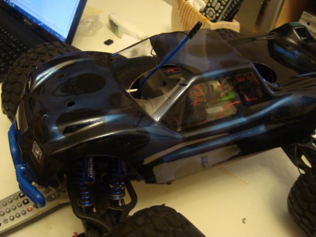

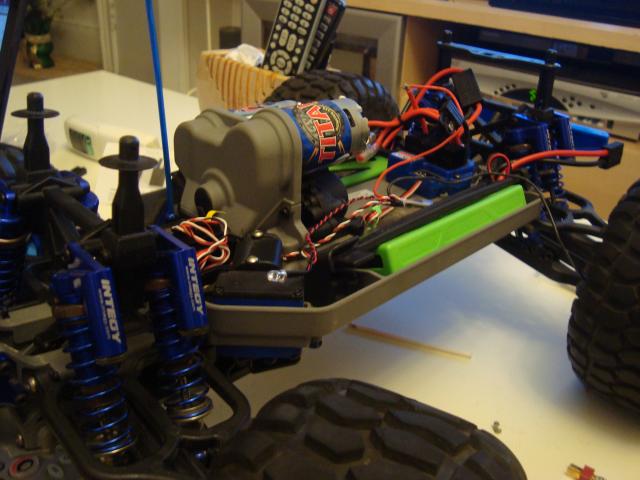

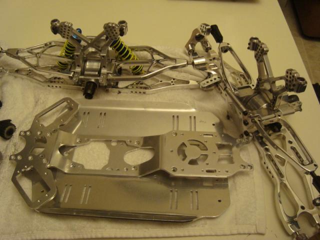

OK I have been in and out and got involved in other projects but I know I can get some help here I have a g4 with several other parts that, i have even bought other trucks to complete but the 3905 emaxx i dont want to take apart ok maybe later but I have gears I purchased for the project. WHERE THE HECK DO I START

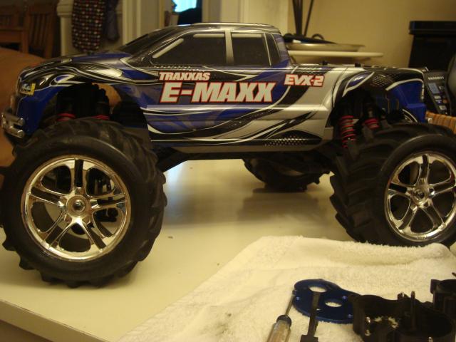

THIS IS THE OTHER TRUCK EMAXX ALSO

Okay, so what you have there is an old 3906 transmission and some metal ( aluminium maybe- are they magnetic?, heavy or light feeling for their size? ) output gears- those are no good for your G4 truck.
You need to hit up ebay for a complete Emaxx 3903/05/08 transmission and motor mount + slipper clutch ( though the slipper can be upgraded easily enough if you need to, there are a couple good options about ).
You can always stick the 3906 tranny back in the old emaxx and run that as it is or let friends drive it etc, to spare your nice truck from their bad driving
05.18.2011, 06:25 AM
Are those all of the parts you have?
Is your goal 1 or 2 trucks?
I believe you need gorillamaxx specific skid plates, which I didn't see. (Neil would know)

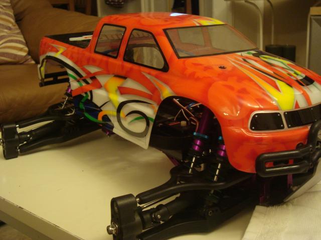

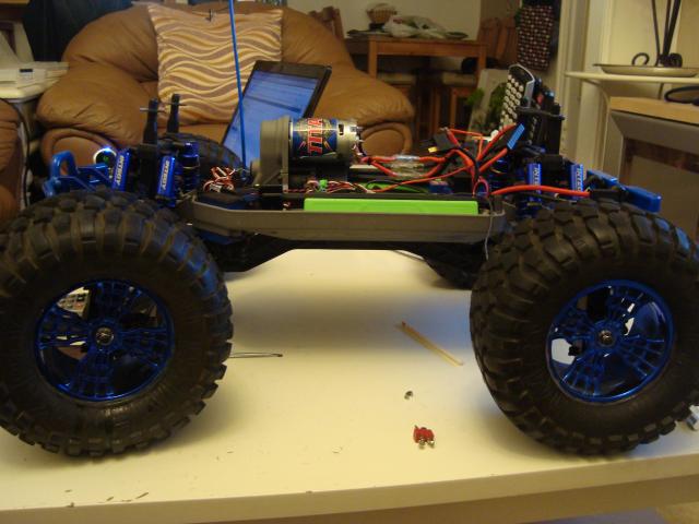

I bought another 3905 and burnt the esc didnt realize after connecting I had connect the correct leads to the battery to the esc to program it I didnt i just connected and turned it on to try and program the remote to after several attempts and haveing the novak smart cutoff connected 2s it just blew but I think something may have been wrong with it

05.23.2011, 11:37 AM
That didnt make any sense at all sorry ( punctuation & grammar , you can't really connect anything up wrong unless you were trying to rewire the battery connectors ( there are only 2 plugs, a battery plugs into each one = simples ). The motors are easy to hook up, red and black wire goes to each motor & it doesnt matter which as they are wired in parallel. The only thing you could hook up wrong is the rx lead from the esc which has to be inserted the right wya around otherwise the esc just doesnt work ( no signal ).
Sounds like the smartstop was wired up wrong and shorted / the esc out...
