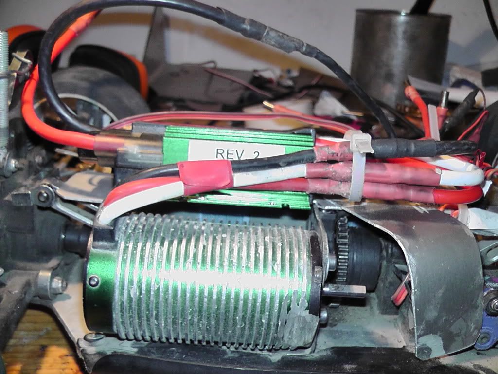

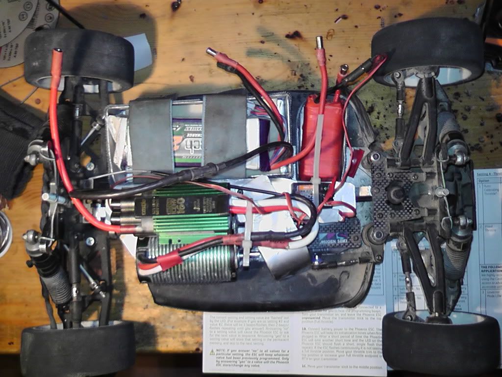

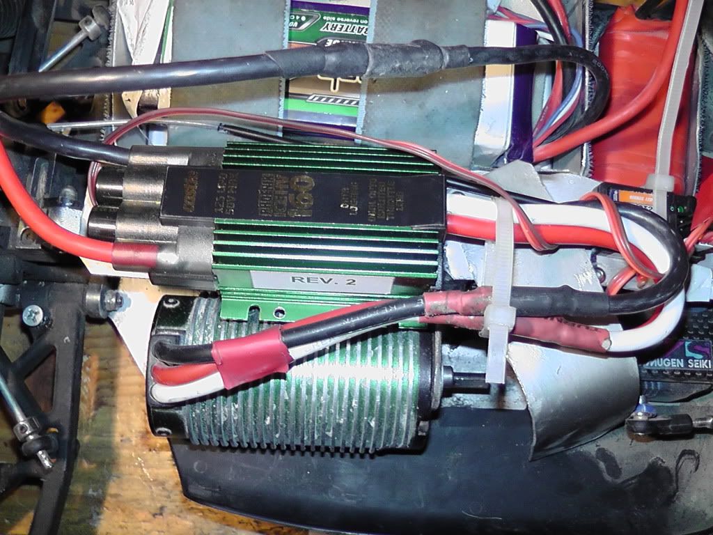

1/8tt buggy + phoenix ice hv160 + castle-neu 1717 + 9-12s = ¿¿¿¿????
soon we will see ........ the next days I will test the beast
with only 6s I arrived at 108mph ....... in the next video "only" arrive at 90mph ......

hey, how many kv is your motor and what battery are you using?

1600kv + 9-12s 35-90c 3300mah ........

use that motor torque to reach extreme speed unless you cant adjust the motor than yeah higher voltage but that motor is rated at 45000 rpm right

ah k, lm looking at doin 6s 8000mha lipos each, but using a ATeking or Castle 2200kv or 2650kv, what would be better and why? and how come you chose such a low kv?

also the 1512 and 1515 are rated at 60.000 ..... and many people arrived at 80.000rpm without broken rotors ..... but using the 1717 I dont will arrive at 50.000 because is impossible ..... the force of the wind slow much the theoric rpm/speed ......
the 1515 2200kv is better thank te 2650 ........simply because is bigger and have more power/w
I tried using this motors and is impossible pass 110mph ........ using the 1717 + 9-12s Im sure I will pass 120mph
