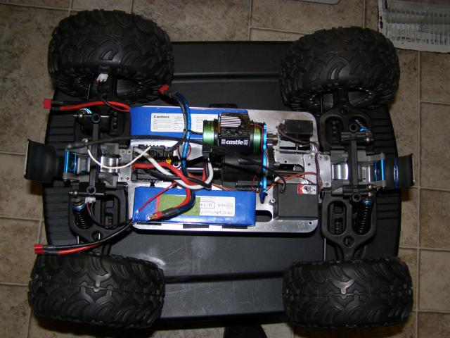

it's my tmaxx now brushless
mikesauto
mikesauto's Avatar
Posts: 47
Join Date: Nov 2011
Location: wa.
01.11.2012, 12:50 AM
2 VX G3 5400mah 2s MM2200KV XTM big block chassis 3906 trany locked in 2nd ue 8 diffs ue shocks mip cvds rpm arms & RPM Axle Carriers ue rear dog bone ofna dom front dog bone hc titanium skid

Got more pics from different angles?
+1 on that.

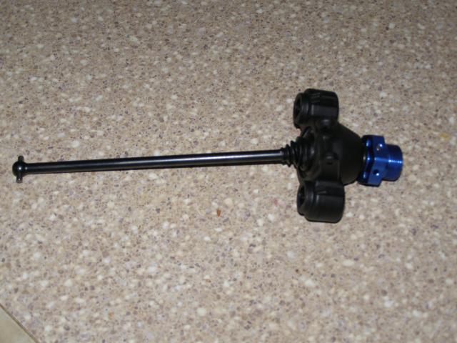

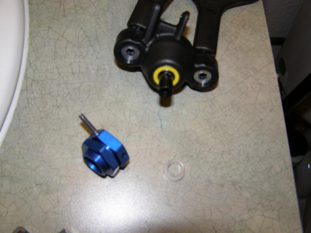

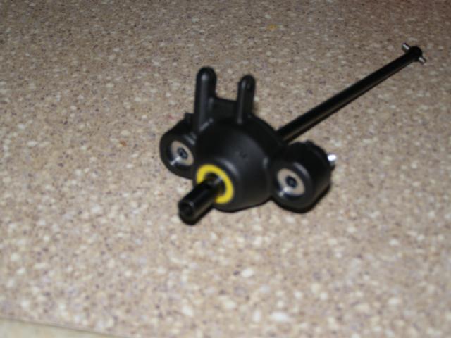

next mod is lst2 axles proline 23mm hex rpm revo carries

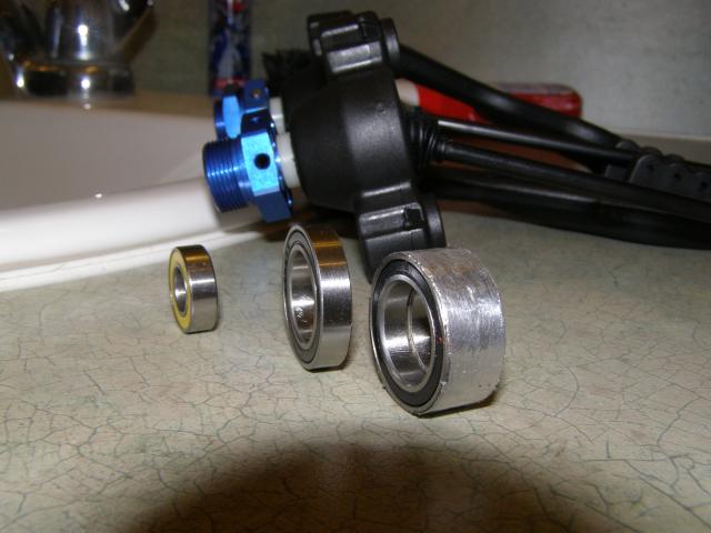

01.12.2012, 11:24 AM
Looks sexy lol. What size carrier bearings (both, inner outer) did you use with lst driveshafts?
01.12.2012, 01:41 PM
I was gonna ask the same thing- every guys that has done the LST cvd upgrade has had to run odd-sized bearing or shim them to make them fit correctly- did you have to do anything special as such?

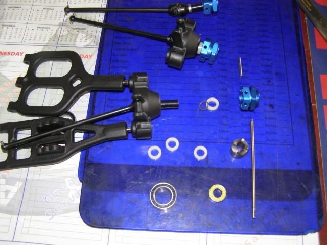

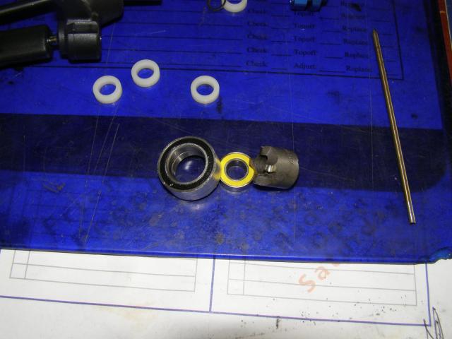

01.12.2012, 02:15 PM
big hole is 24.5mm I used two 15x24 and alum tape. small end is 15mm now 5/8 so 16x8mm fits good and tight I'll try to post some better pic of how I did it later

Did you have to drill new holes in the axles? Nice truck BTW.

01.12.2012, 06:17 PM
thanks Kcz25 looks like I can run it with some shims (3mm) or small spacer or drill new hole still in the works

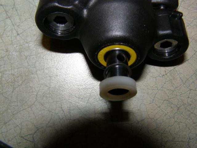

nylon washers 5/16
mikesauto
mikesauto's Avatar
Posts: 47
Join Date: Nov 2011
Location: wa.
nylon washers 5/16 - 04.16.2012, 04:30 PM
nylon washers 5/16 + 1 8mm shim

pics - 04.16.2012, 04:40 PM
got the washers fror hardwear store

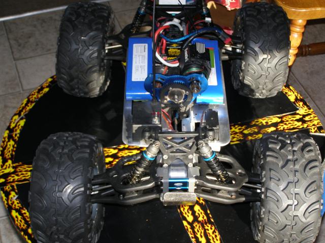

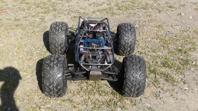

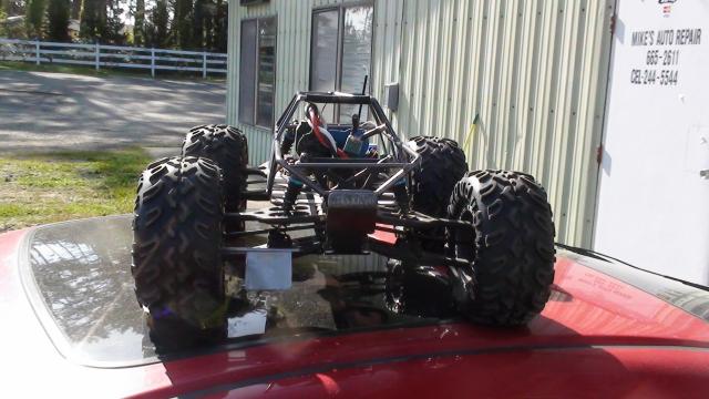

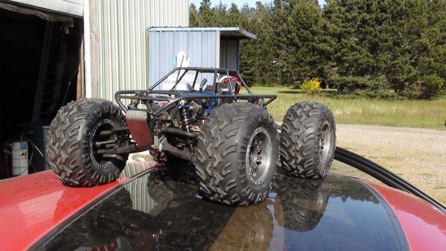

painted my cage and fixed some bad welds - 05.24.2012, 11:55 AM
and put lst 2 axles on the back hard to see but it's an inch wider in the rear
