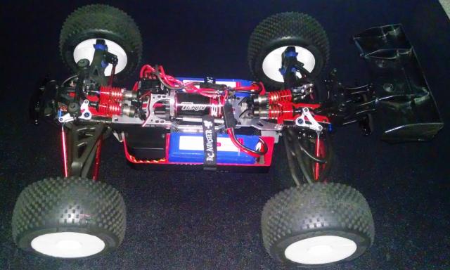

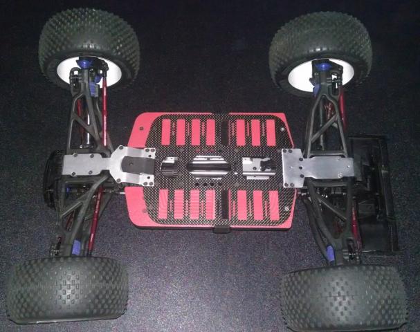

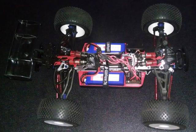

I recently finished a pretty cool Revo project and thought some folks may enjoy the pictures. I started with a G2R, but remade the upper plates with 7075 and removed the servos from the top plate. While I was at it, I stretched the rear upper plate and lower skid by .5" for aesthetics and to fit the stock ERevo body. The Lower battery trays are pocketed around the CF lower plate - 1 side houses the ESC and th other houses the steering servo and custom rx box. The truck also sports a custom center diff mount, and some custom CF sticker sheet in red(top diff plates) and black(side of battery trays). The rest of the parts are off-the-shelf hop-up parts. Sadly, the truck was done for an existing customer, so it will be leaving my possession very soon - I did make twins of the parts for my own G2R, though. :)
Here are a few pictures:
