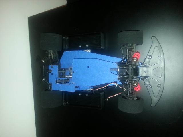

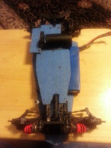

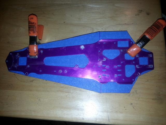

I finally found a decent roller on Super RS4 on Ebay and started the rebuild process. With the car in and stripped down to the bare chassis, the plate in, I blue taped the plate, and traced out the template and cut out the new chassis.

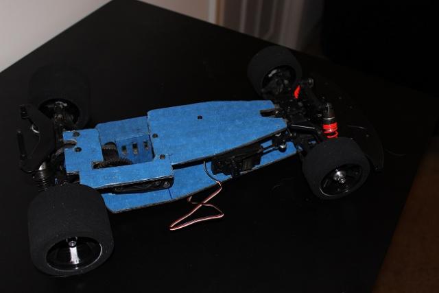

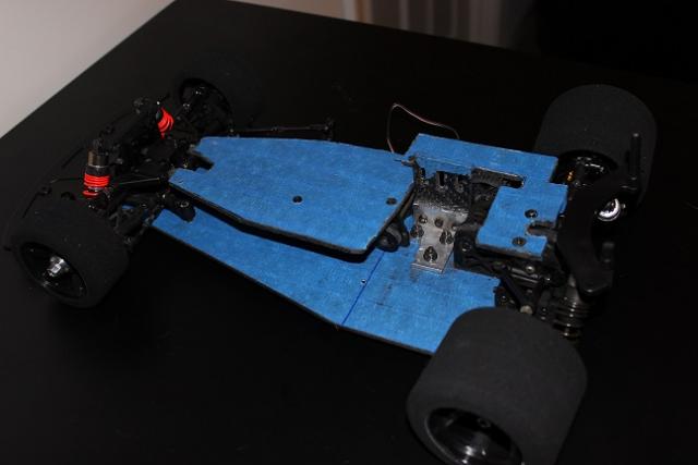

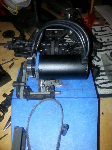

Got a chance to work on the RS4 some more. Got the top plate cut and fit, got the 2 piece motor mount installed and finished the rear brace plate installed. Servo going in tomorrow and battery trays soon.

That is a huge pinion. What motor is that?
6 KiloWatt A123 Racer
24s2p EVG SX 49.6mph Ebike.
Big House
Big House's Avatar
Posts: 372
01.15.2014, 10:01 AM
That is just a test fit 30t pinion but it does let me know howbig I can go. I can go bigger than that but I am going to stay there or smaller for now. The motor is an HPI Alphastar 2350kv.

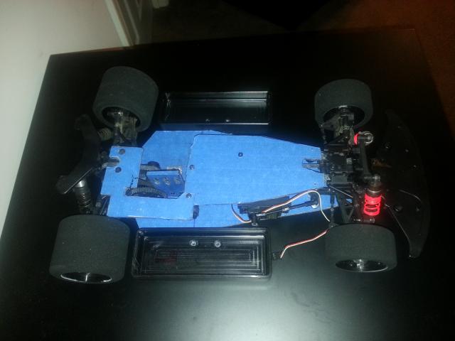

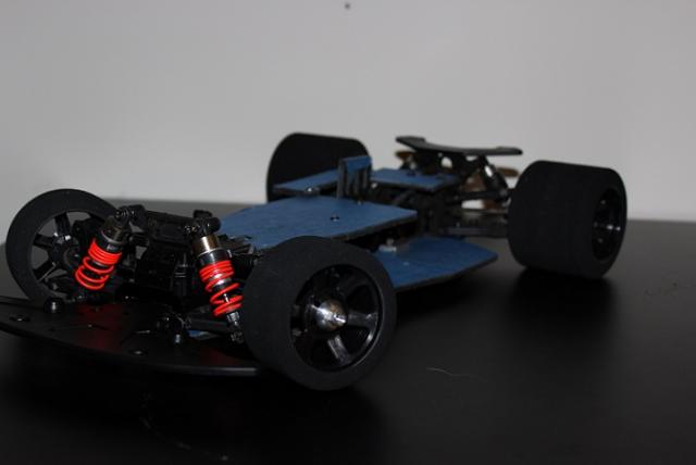

Yes I am. This is carbon monster #8. Almost done with this one. Chassis clean-up and tape removal is that last step. Put the whole car together to make sure everything went together. The last things needed are the batteries, battery trays, body and the Mamba Pro.

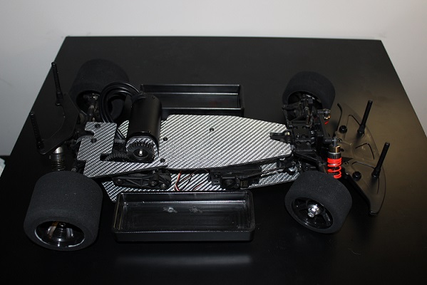

One step closer. The battery trays came in today as well as the pinion. Should clean up the chassis and finalize the assembly tomorrow.

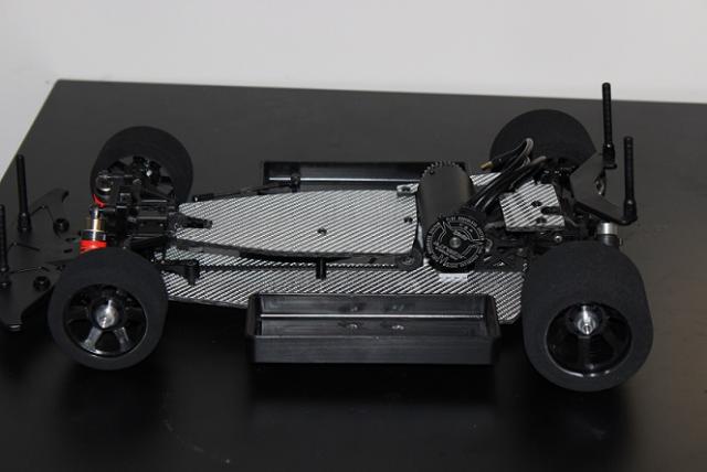

THe Silverback is born... - 01.20.2014, 05:08 PM
After cutting shaping sanding and sealing, the Silverback is born. Finally got everything in and done. Got the battery trays fitted and attached and took off the tape. Motor is meshed and will probably be a rear support brace because I think it is going to be quite torque happy. Bench test coming once I get the Mamba Pro in.
