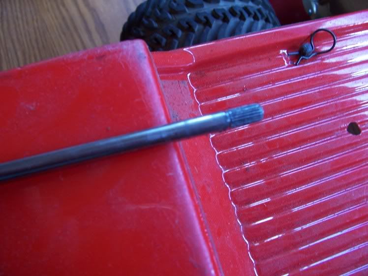

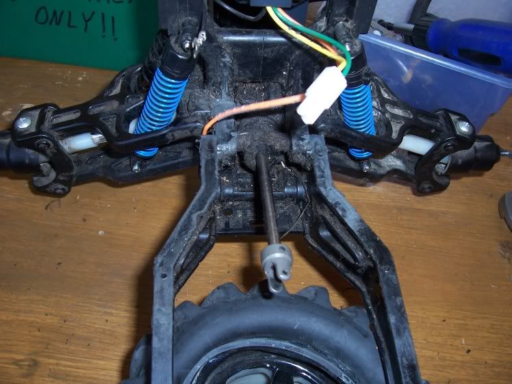

Exactly how does that work? I never heard of doing this, sounds interesting, so you just use a center diff from a buggy and mount the motor near it and have it turn the spur gear on it? You happen to have a pic and how to or of how this works? Sorry for all the q's but never heard of doing this. EDIT: I found some pics and get how it works now but the thing is w/ this Crusher they use driveshafts and output yokes instead of dog bones and all the center diffs I see run dog bones, There is no way that I can think of to convert the center shafts to dogbones because the center shaft is splined at the end where it goes into the f/r diffs , so I dont see that happening really. Any ideas? Also would a 9L be able to power this decently? Go atleast 40mph? and decent runtimes?

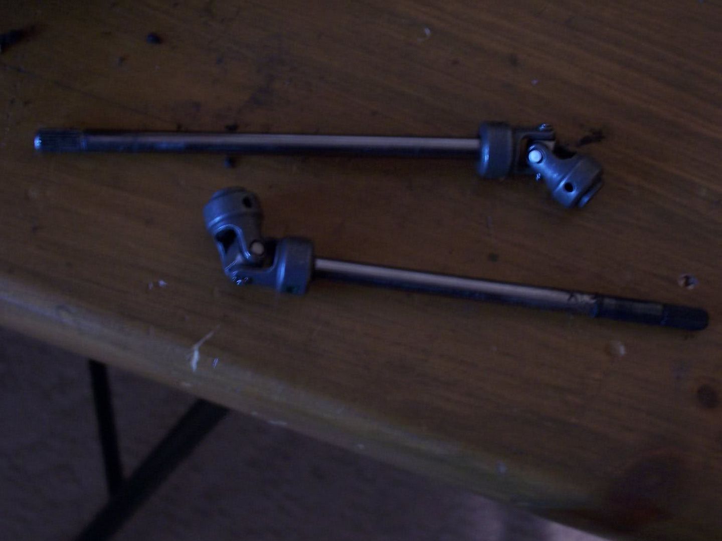

Actually, a center diff might not be possible because of the splines on the pinion gear in the diff. I have never seen a truck like that. If you have access to a mill and lathe, you can probably make it work though.

Yeah as you can see it is a splined axle so I dont know if anyone can make dogbones like this. I think I'll just do the tranny, I got the output yokes on these drive shafts to fit on the E maxx tranny out put shaft, just needed to drill a slight larger hole in the output shaft.
http://i35.photobucket.com/albums/d1...k/000_1122.jpg

That looks like going to make the conversion a little harder. For the size of the truck I would go with a xl motor. If you want a L motor I would go 10L for 12 cells. Should keep the heat down but don't think it is going to get the speed you want. Some of the center diffs had removible cups on them. I got one off ebay. It was for a ofna mbx i think.
